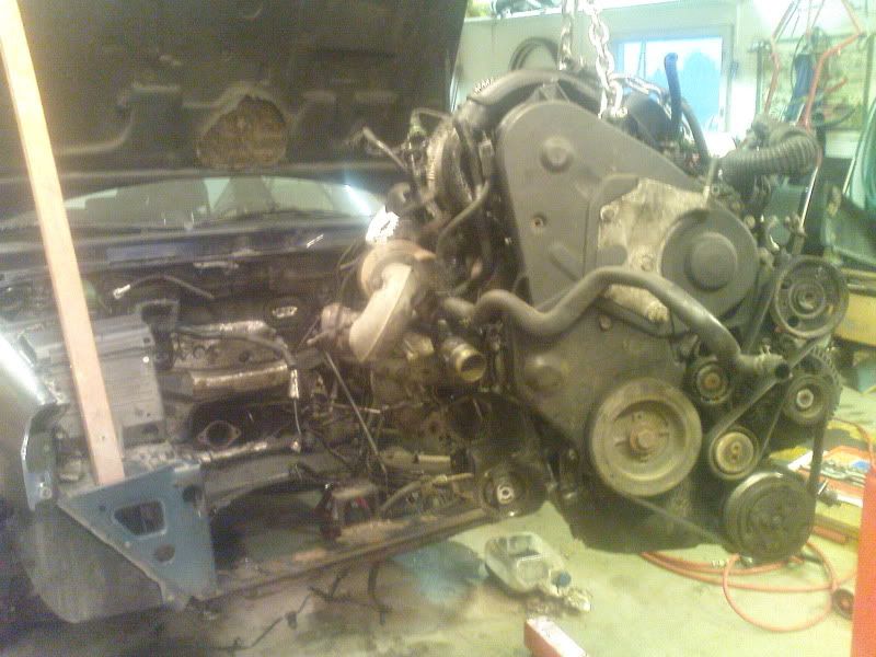

Hi!
Finally I desided to do something for finding the reason for strange noise and vibration. Yesterday's status of that project:
[/quote]
I have recerved an other maintenanced transmission and new flywheel for my Xm. Unfortenately that flywheel is from bosch pump engine. I have to do two extra hollows to the rim for EPIC timing.
Tero
Tero

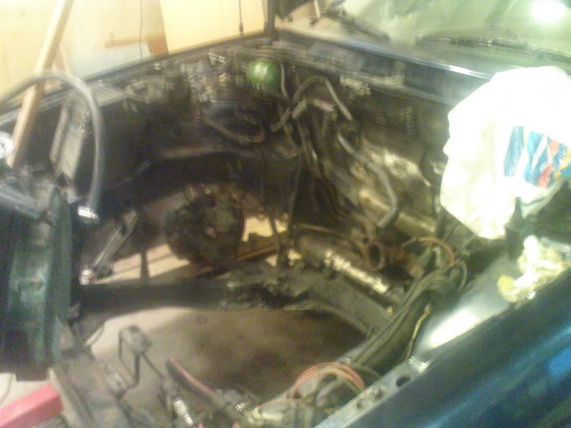

Re: Flywheel for 2.1TD EPIC automatic
Hi!
Now the pagage is back under the hood and works find biggrin.gif I got it done yesterday after a couple months project time...
Only problem left is ABS. There was some errors every now and then, before this big transmission change (sometimes ABS light stayed on). Now the light shakes a little bit when it should turn off but then stay on.
Any ideas?
Any ideas?
