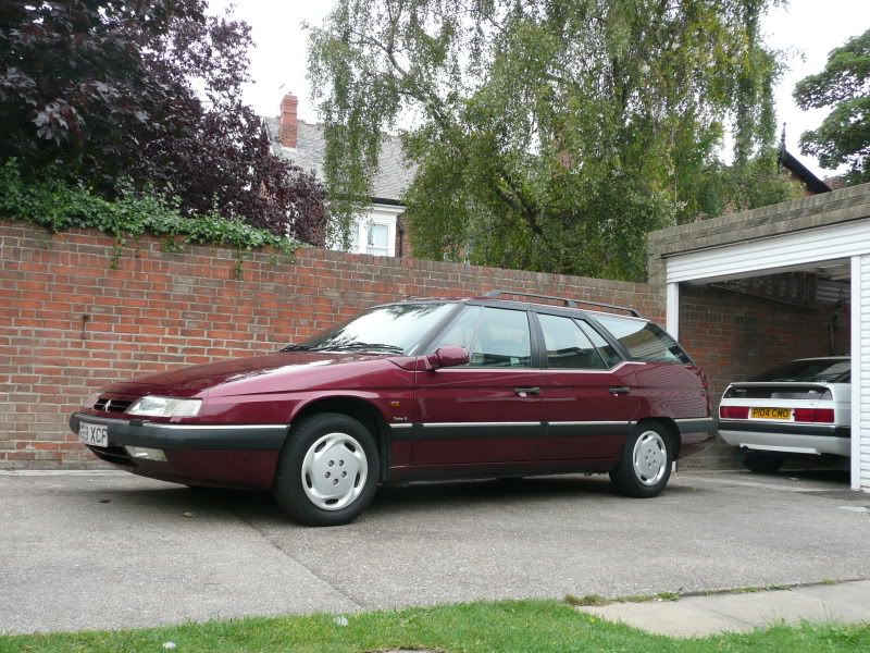

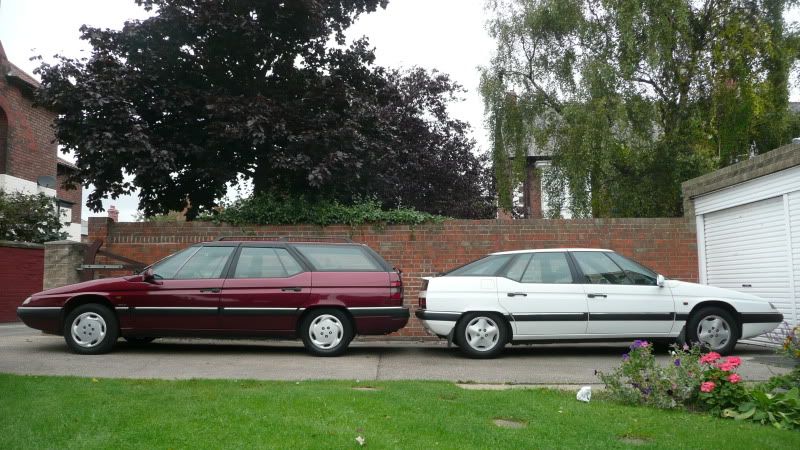

Seems a good car though, obviously niggly points but it is 14 years old.
Ive taken some pictures but dont have time to upload them all at the moment, but here are two:
Will post the others when i get in from work.
