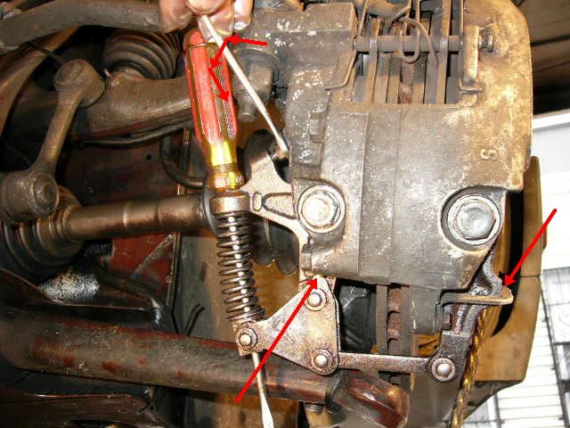

How are people adjusting the handbrake, not merely by the cable, are they. My memory of GS says the pads should be adjusted to bring them in to the disk, then the cable adjusted to take up any slack.
If the cable is used instead of the pad sdjustment it keeps going out.

Here is a photo of the handbrake mechanism, I don't know how it compares to a GS setup.
Here is the guide where the photo came from for reference.
http://www.tedperkins.com/handbrake_rem ... eaning.htm
http://www.tedperkins.com/handbrake_ins ... stment.htm

Re: What on earth is this?
It's a torturous and ultimately useless setup despite trying to be elegant in it's execution.
The real objective when the car was designed was for the Cx to use inboard disks (as per D and G models)
on an aircooled flat 6 and/or a tri-rotary engine and the eventual setup does smack of lastminute.com design.
Decent description here:
http://www.aussiefrogs.com/forum/archiv ... 26973.html
It helps if the handbrake pads are new/meaty and the cables aren't stretched mind.
Andrew
