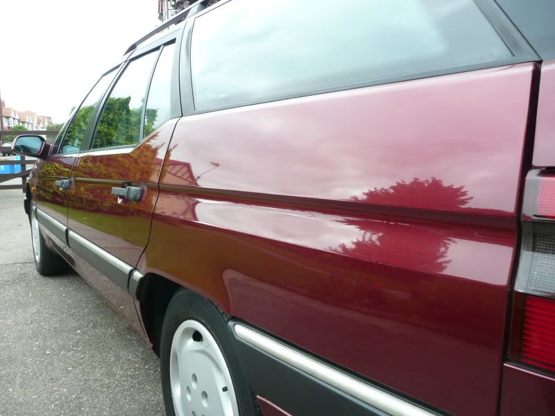

Well im not entirely sure, how it even left a body shop looking this way ive no idea. However the panels seem good, i cant see any other signs of damage so my guess is its just been a small scrape. I had a little magnet (padded obviously) earlier to see if there was any filler in the door and wing, or the rest of the car actually. There is a tiny bit of filler in the bottom of the drivers door, seems almost like a circle of it, but i couldnt find any anywhere else. The rest of the paintwork seems to be original. It still has original Citroen dealer number plates too.
To be honest with a car this age (and size!) you expect it to have had a tiny bit of bodywork at some point, so i dont mind that, just the fact its been so badly paint matched is very poor.
Thats a big down side, well the biggest downside to the car, the milticoloured drivers side. So ill have to get it into the bodyshop and get that repainted before too long. The bodyshop we use is a total perfectionist and hates using filler where not needed so im sure he will be able to have it sorted out quickly, however he is also the most costly too, but a good job is worth it.

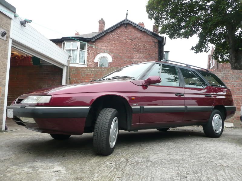

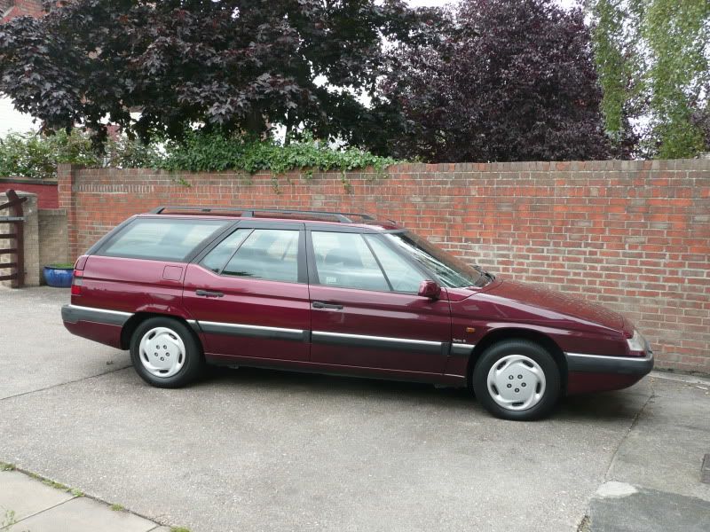

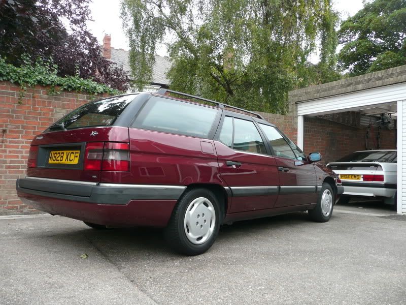

Few more pics:
Now the bad side:
Should look better with a good polish and the black bits blacked. :) And when its all the same colour :roll:
