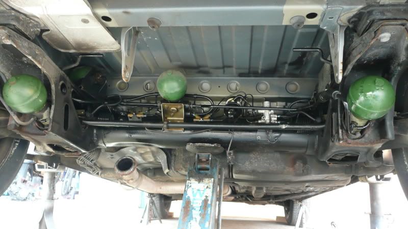

The sphere in the centre above the rear suspension is the hydractive sphere, the one responsible for the soft ride, and yes, it is very often overlooked, its almost a waste of time changing the outer ones unless that one is changed as well. The anti sink sphere is an extra one at the rear, giving a total count of four. I have never seen a 2.1 with it fitted though.

Very odd, i was sure all S2 Xms have anti sink :?
This is where it is on the 2.0 hacth:
Top left of the picture, tucked out of the way, with the centre soft sphere in the middle.
Ill have a look at the estate later today, see if that has one. Doesnt look to be easily seen though.

Indeed your right Peter, there is no anti-sink sphere hiding under there! :o
Although it seems to stay up rather well, when the anti-sink wasnt working on the silver hatch it only took around 10 hours to sit down, but this estate still wasnt in low after over 24 hours. So it must have some way of helping stay at the correct height?
First ive heard of some S2 cars without an antisink sphere. :?
