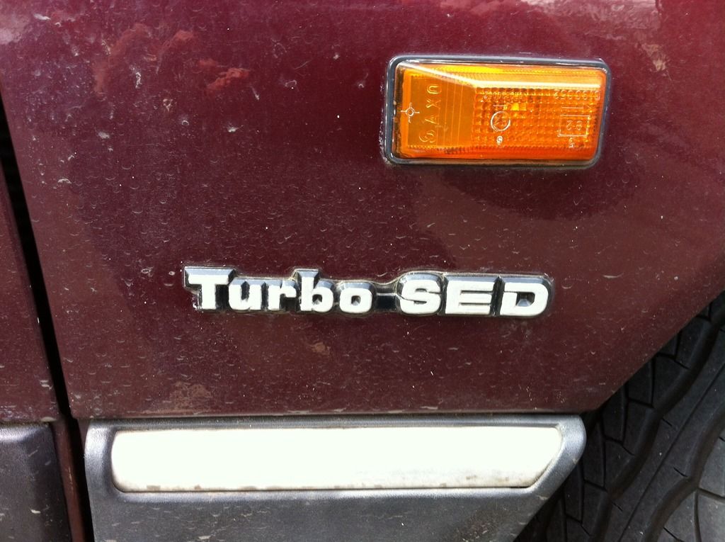

I thought I might have pics of the way I did mine, but can't find them.
My method....Stiff bit of cardboard. Blob of bluetack on the back as a handle. Then a layer of high density neoprene foam stuck on the card. Get it in sheets from an artshop. Then chrome model paint on the foam. Remove excess. Press lightly against the badge and it should only cover the surface and leave the sides black. Clean up with a bit of white spirt if needed. Clear laquer over the top. Works a treat and it lasts.
I'll get some pics of mine if you want to see Rob.
Re: Wanted: Si wing badges
Very nice Russ but such a pity we did not get the metal badges used elsewhere! Regards, Matthew T.
