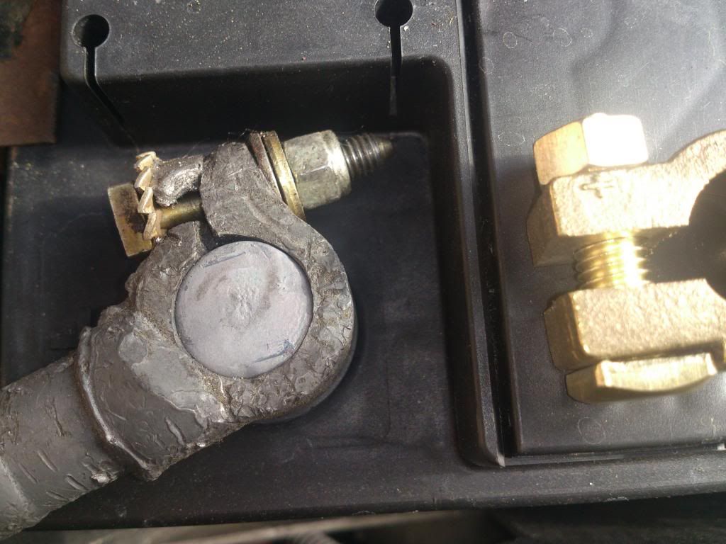

Thanks for the pointers - I did notice that one of the battery terminals is damaged with a split to the leaded part - maybe was over tightened once but it isn't held on well. I replaced the terminals and the leads on my Xantia to good effect. I opted for the 'marine' type that use a wing nut. Think the XM should get the same type as they can give a really tight contact.

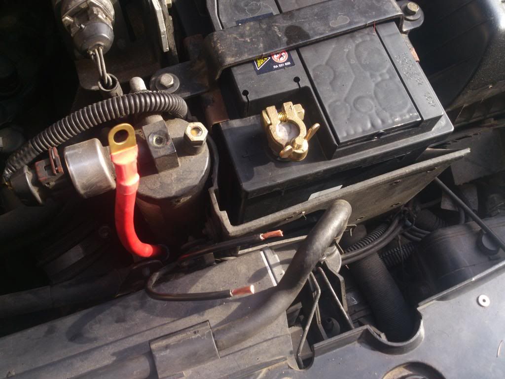

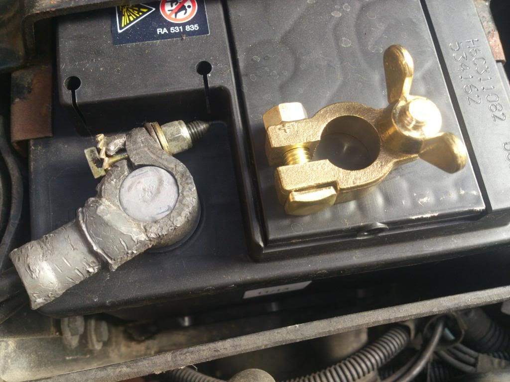

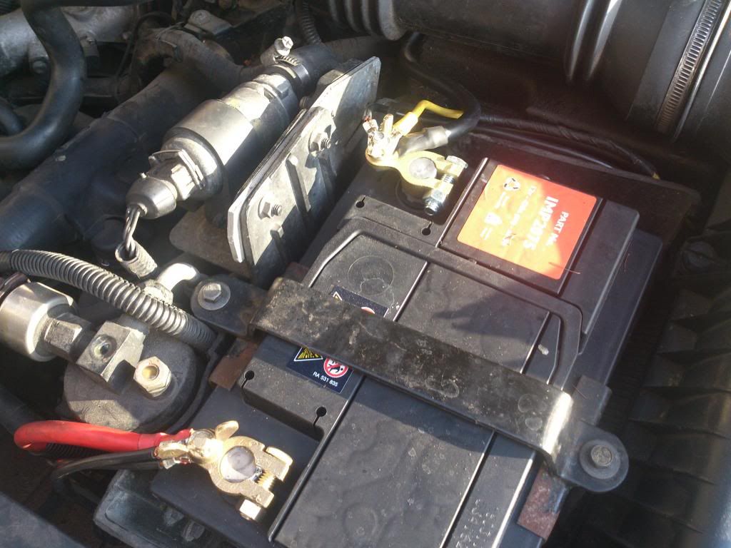

Minor update - battery terminals.
I didn't expect to have to replace this sort of elementary stuff but it became essential after I spotted one of the battery clamps was broken and loose.
I opted to replace both the terminal clamps with the 'nautical' type with wing nut fixings and as such, replaced the battery leads too.
I did this on my Xantia after all the talk of Xantia battery leads getting hot and starters churning over slowly. No symptoms of this on the XM as yet but I feel XMs need no excuse to have electrical fits so all connections were replaced or cleaned.
Prepping the leads and connectors
Cleaned up and replaced the lead to the starter
And finally the terminals
But I felt the wing nut connection on top of the positive was too high and might actually be contacting the underside of the bonnet (though I coulnd't actually confirm this) so I topped this off by replacing the wing nut on this terminal with a normal hex nut
No change in performance of anything so far as I can tell but it eliminates the potential for problems. No improvement in the suspension either - still sticks in sport mode.

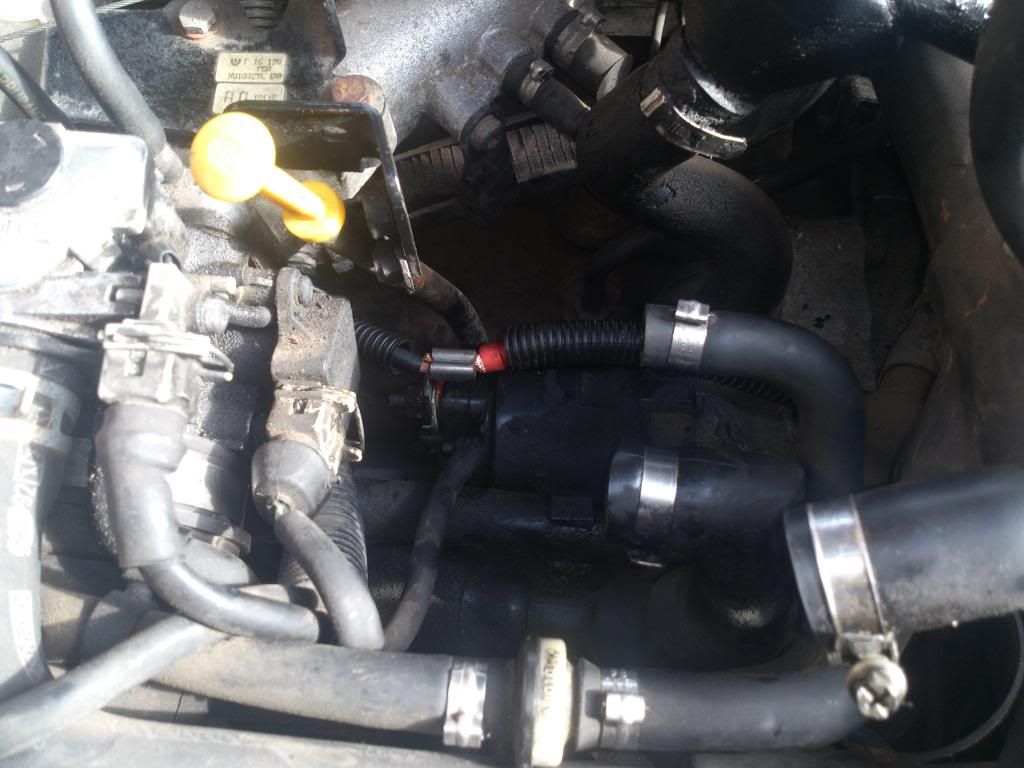

I confirmed it by tuning the radio to MW and LW - both picked up the hydractive solenoid, confirmed by moving the accelerator quickly where the tone cuts off to return after a few seconds. I suppose this means the hydractive is actually working and now after changing the rear corner spheres and all three fronts, the suspension is mega soft until switch off after the door is closed it goes hard when the audible clonk is heard after a delay - familiar stuff.
But now with the radio it confirms that the automatic suspension works for less than a mile after sturt up after which the suspension is firm and the tone on the radio is gone. Stopping, parking up and returning to the car after say 5-10 minutes shows that on restart the hydractive is 'reset' and it works in soft mode again for nearly a mile.
I feel this is a common problem on Hydractive 1 cars. I cleaned all of the ECU connectors including the engine ECU with contact cleaner in case it also heled with the throttle response problem I occasionally get but no change to the suspension and the car actually ran worse after the clean up - I'm now getting terrible idle on start up on occasion (say, avery other time) where is starts instantly, idles high for a few seconds then drops down to a barely running state where the whole thing struggles to keep going like a nearby sneeze would stall it - it did even cut out once though restarted fine. It seems to always get through this and then run ok. What could be causing this? Lambda sensor? ECU vacuum hose? The petrol pump can be heard priming ok on ignition switch on.

I did some research into hydractive 1 faults and think that the ' getting stuck in hard mode' while it does reset after a restart or disconnecting the edu and reconnecting, then I think the cause is a faulty sensor making the ecu go into fault mode.
I read that disconnecting the s Speedo sensor (as a first prod at the problem) doesn't work because the ecu ' knows' it's open circuit however this seems to only be on hyperactive 2 as far as I can find ( solid info seems hard to come by)
Anyway I disconnected the connector for the speed sensor and switched on the ignition to find the hydractive light comes up as normal for a few seconds- no flashing or staying lit. Ran the engine and it is in soft mode so looking like this can run with it of for now
Ill find out later if this makes a difference...

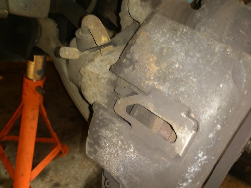

First of all I fitted new brake pads to the front today - nice and cheap from AEP in Rutherglen. Positively the brake caliper pistons both retracted easily so that's a success (the first with this car) and the new pads fitted. I found that the bad parking brake was not caused by the wafer-thin brake pads but by the detached brake cable
this is the same as on my previous blue XM. Seems that if the cables are lacking in their full tension when released, the end can pop out at the balancer end.
Well, the end that would be the 'balancer end' if XMs had a brake balancer! I mean the lever mechanism. Anyway it was a case of re-locating it under the car while I was replacing the brake pads.

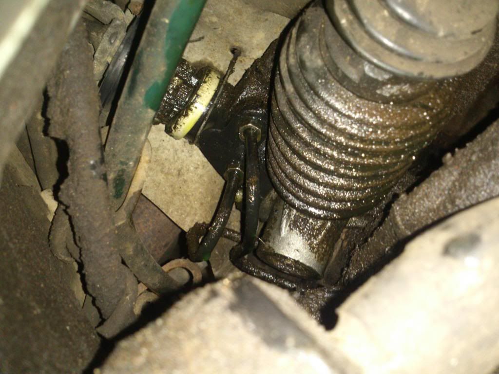

I had a look at the leaking steering pinion valve finally.
Wish I hadn't! It does appear to be leaking from the highest point on the thing: you know, the shaft seal..... I'd been kind of hoping it was one of the pipe connections needing nipped up which was exactly all the Blue XM needed when it leaked here.
Not sure if it's clear in the picture but this revealed the LHM is oozing out above the pipe unions and the only exit for LHM above this level is from the actual rotary seal of the valve's shaft. This, of course means replacement...... there's just no other option. And I'll say, this pinion valv looks a thorough **** to remove. I'm half wondering if this -due to the totally inaccessible look of it- is beyond my garage skills and facilities. Anyone done a pinion valve change on a 2L turbo??

Post by xmexclusive » Thu Jun 05, 2014 10:40 pm
The parking brake cables jumping out at the caliper end can be caused by a weak internal spring on the pull arm.
Had the problem a number of times on one of the estates.
I bought a box of assorted springs from Screwfix.
Found a springs size that threaded over the cable.
PIA to fit but gives a superb snap open to the parking brake.
