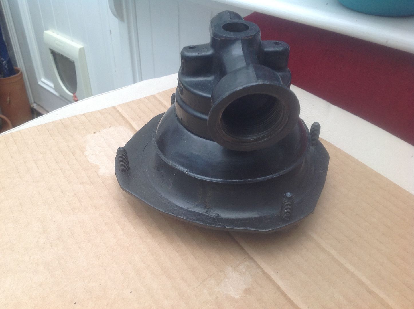

To aid the peace of mind and help lower the blood pressure, last week I fitted new refurbed strut tops kindly supplied by Aad in the Netherlands. Having seen Jaap's strut tops, and his enthusiasm for the quality and improvement in steering, I was convinced!
Trouble was Aads contact details have changed, so trying to get hold of him to begin with was a little frustrating. But I got there in the end and as of last Wednesday now have them on the car. The old tops weren't about to fail, but they were starting to crack and splits were starting to appear. I had a significant amount already in euros left over from the Citroen challenge last summer, so I bit the bullet. They aren't cheap, but you get strut tops that look OEM.
This is them.... I'm very pleased, and they have the an anti pop through ring welded in. Aad prefers to exchange them rather than rebuild your own tops.

It was good to see you on the weekend Russ and to catch up and those strut tops certainly do look impressive, both on and off the car - a hundred times better than the other firm I used!! The other jobs that you have undertaken and planned on the brakes etc. also sound very sensible. With regards, Matthew T.

Those strut tops look really good, can you share details of cost and how to make contact with Aad?
