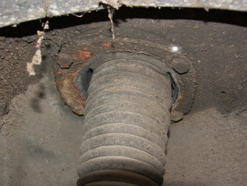

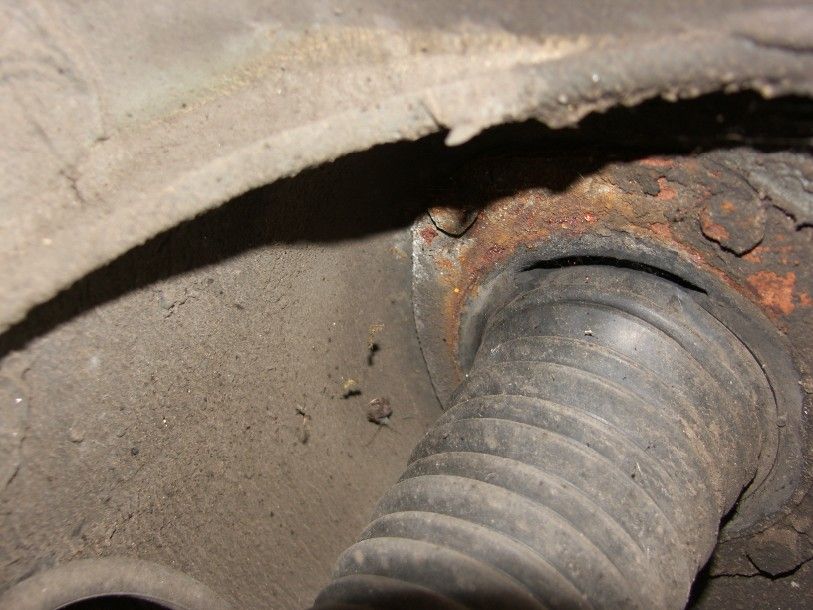

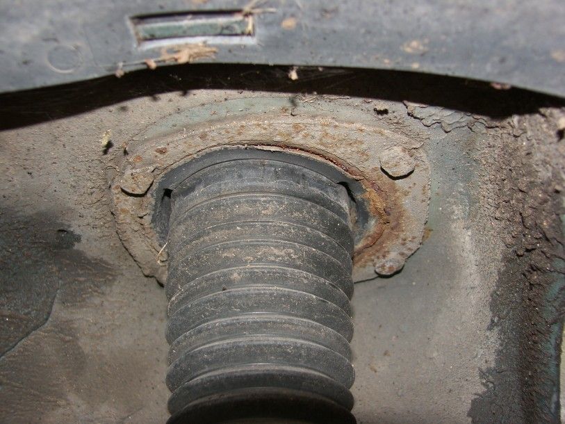

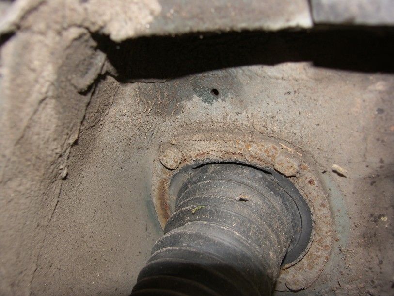

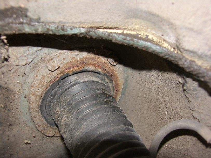

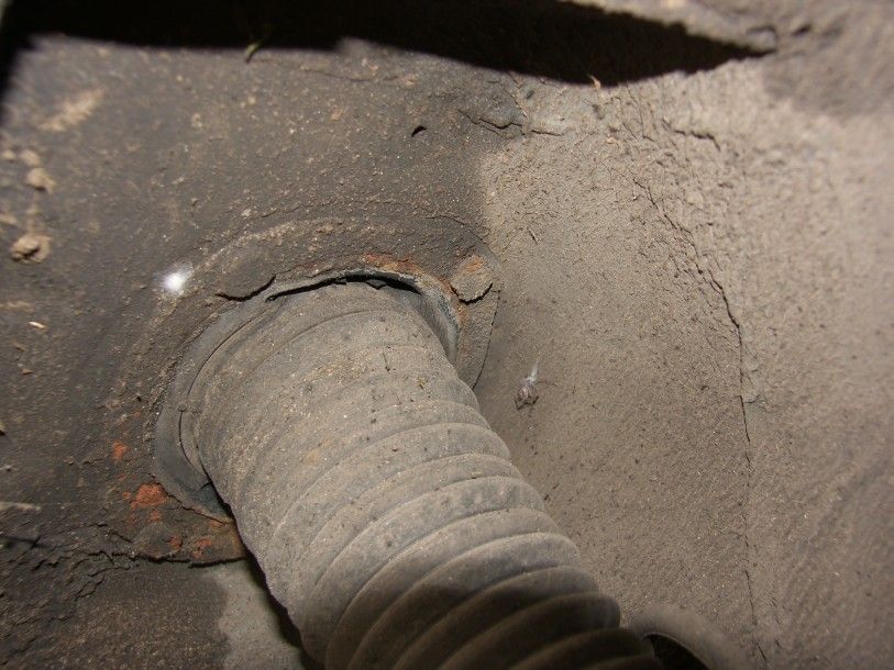

Right here are the under arch pics, drivers side -
And passenger side -
whats the verdict? I think that the drivers side looks like the bonding is starting to part company with the steel?
Re: 1998 XM - 2.1td - More Strut Top Pics!
They aren't bad. I have seen much much worse.
- Posts: 5931
There is no sign of Axial Tearing on either strut head. (A)
There is no sign of significant metal loss from baseplate underside rusting. (B)
On both there is evidence of the first stages of debonding between the top of the rubber cone and the baseplate cone. (C)
There is some evidence of top rubber peel. (D)
Examination for significant metal loss from top side metal rusting (E) needs a bit of manual intervention rather than a photo.
Seperation of the inner cone. (F) No check but not likely.

(E) - Topside Rusting
The baseplate metal rusts away from the top.
On an XM strut head this is usually an advance stage of top rubber peel.
The two high risk areas are the inner edge of the baseplate centre hole and the bend to form the cone.
If significant rusting increases the actual size of the baseplate centre hole then it makes Axial Tearing failure much easier
and more likely to happen.
Examining the steel making up this hole is difficult because of the cover on the head centre and the presence of the top
rubber on the baseplate.
Poking about here with a screwdriver is not a good idea.
You are more likely to start axial tearing than find rust holes.
Visual condition of top rubber bond is quite a good guide.
If the top ring of rubber is firm, it normally is, then there is no problem.
With the bend to form the cone fortunately Citroen stopped the top rubber just before the bend.
The bend does trap water but that water is exposed to the atmosphere and dries quickly.
There is usually some surface rust formed here but I have never seen any serious problems on XM's.
Probably helped by the steel crystaline structure being tightened on the inside of the bend making rust penetration more difficult.
(D) - Top Rubber Peel
The top rubber of most XM strut heads will eventually bubble and peel in places.
It usually starts from the bottom edge of the rubber.
When peeled you find platelets of rusty steel still bonded to the inside of the rubber.
I believe that this is caused by poor specification or quality control in the baseplate pressing.
The rusty steel platelets are typical of a steelmaking defect called "Mill Scale".
Mill Scale is caused by a build up of dirt and impurities on the mould forming faces of the press.
It is logical that the top raised face of the baseplate gets the worst of the mill scale.
Mill scale is effectively a minuture rust cell pressed into the face of the steel.
It will eventually destroy any surface finish applied to the steel.
Thin bonded rubber finish in this case, presents no barrier, the rust cell under it expands over time and bubbles the rubber up.
At the edges and when the rubber cracks the flap stays there but now water and air can be drawn in by crapilliary action.
If left rusting starts in ernest.
Rate and extent of this problem depends entirely how much crap the pressing process puts into the steel baseplate surface.
I personally strip this surface rubber at first sign of bubbling.
Check the underlying steel for deep rusting (unusual).
Then clean and Hammerite the steel.
(C) - Top of Rubber Cone Debonding
The above checks have made sure that the metal baseplate cone is not rusted away.
So the rubber cone debonding from the underside of the metal baseplate cone will not in itself risk bonnet pop-up.
There is still full vertical support even when debonding is total.
Car in this state is a MOT failure due to a loose suspension component.
Jacking with the wheel hanging shows the fault.
Gluing with a structural adhesive may effect a short term repair.
The refurbished strut head photos added below by XMX show well the bottom anti-pop-up ring that Kingas welds on.
It is a steel ring rolled from 4 or 5mm wire welded on the outside bottom of the steelcentre tube.
A similar ring is also welded to the underside of the baseplate centre hole.
These rings are of a similar diameter so cannot pass but at worst will lock together if the strut head rubber fails.
I am considering asking for the bottom ring position to be moved up a bit on my next batch of refurbs.
