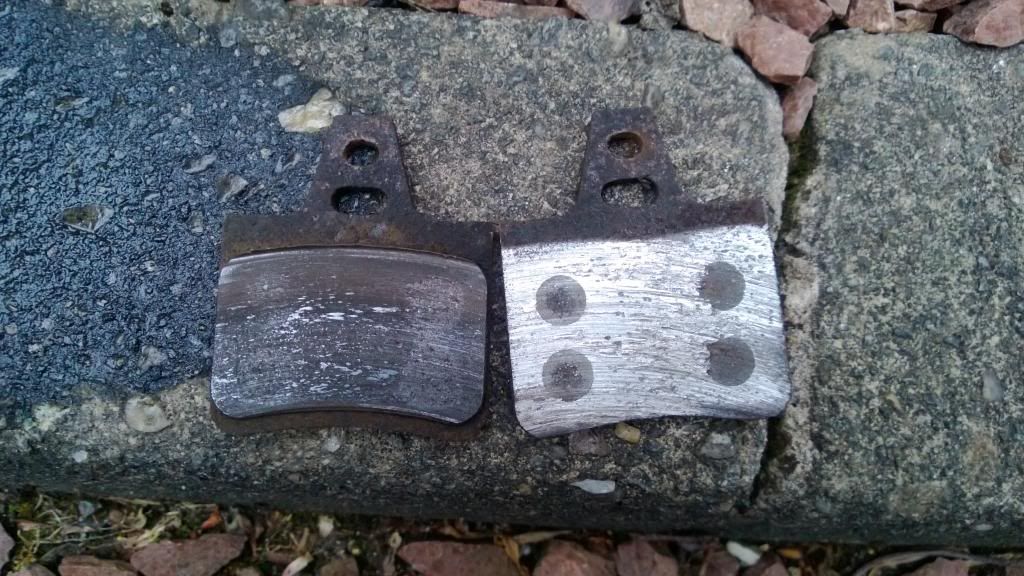

I previously mentioned the grinding from the rear that was occurring- I sourced some nearly new front discs and pads from a forum member, and NOS rear discs and pads.
Time for some more work....
The fronts were changed without too much problem, though I see that those parking brake cables can be tricky to put back into the retainers!
When I got to the back, well- I found cobwebs within the calipers!
The NS one revealed the fairly obvious problem:
So with all discs and pads changed, I bled the ABS block, did Citrobics, and yes, things were well once again.
I did notice that after this the car rose as I believe it is supposed to, rear first, then front. Previously it had been the opposite of this.
