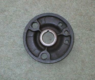

I nice clear picture of the Crank! Now, just to make a point here which I fell for!
The Key way DOES NOT and is NOT supposed to line up with the Gapped alignment next it in the Picture.. Thats for the TCT engine which it does!!
If the Timing lock is fitted to the flywheel this comes true. I made the mistake by being lazy and lined the keyway with the gap, making it a tooth out retared... Only after reassembly did I find a no go..
This shows that the 2.1 and TCT use the same block casting...

citroenxm wrote: Thats for the TCT engine which it does!!
Are you sure Paul? I'm not at all sure it does as the gapped alignment is for use with the timing hole in the crank pulley...
Which can never be relied upon of course as it's a dual-mass device but with a solid pulley it's perfect for the job..
Here's a picture of my test timing pulley for the TCT engine. The timing hole is the middle one of the group of three and it does not line up with the key-way...
Or am I missing something here?
