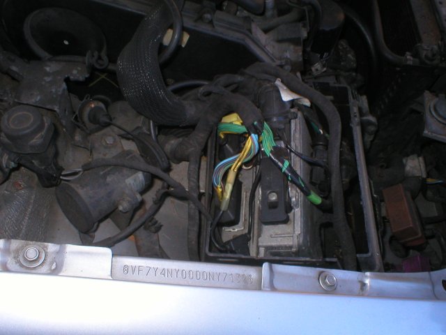

We found the Team WFA 2.5 had been 'modded' in the Hydractive department to hold the electrovalves open and the suspension in permanent soft mode.
Here's the evidence:
After replacing all the ruptured spheres (most of them!) I took it for a drive before putting the ECU wiring back to normal and doing the diode mod.
In permanent soft mode the handling is truly atrocious. It rolls like a barrel. After undoing the bodges and clearing the faults in the ECU handling was transformed...

Yes, and a read and clear of stored faults. What amazes me is how the electrovalves themselves survive constant 12v for such an extended period. It was always believed they were driven by a pulsed signal of just sufficient amplitude to hold them operated because they would rapidly burn out if subjected to full 12v for any length of time. Normally they have just half a second of full 12v applied to them to operate them before the pulsed signal is applied to hold them operated.
These two at least have survived unscathed... They're tougher than we thought.
