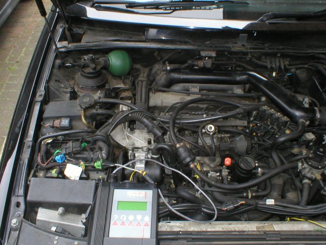

As another prong in this attack, I'm going to try and get my ELIT talking to my XM. At the moment I don't have a two pin lead for the ELIT as I always use it with its 'piggyback' for the 16 and 30 pin plugs. I have the hardware and I think I have the pinouts for the two-pin so I'll try to get a lead made up and tested ready for CXM.
Re: Captain Slow's Series One XM
Post by CitroJim » Tue Sep 04, 2012 1:26 pm
Got my ELIT working on my XM after making up a lead for it...
Works a treat so I'll bring it to CXM.
Here it is in action...
I like my ELIT. So much easier to use than a Lexia and more in keeping with an XM I think...

Post by CitroJim » Tue Sep 04, 2012 4:13 pm
Tested working on ABS, Engine and Hydractive so far...
