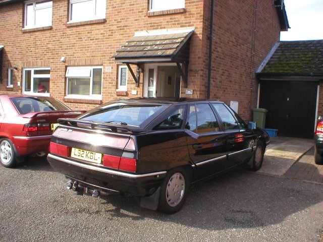

Following Chris's fine work with the machine polisher yesterday I gave the Mobility Scooter a quick wash to remove the polishing compound that looked like she'd been in a snowstorm
and then a good rub down with a chamois leather.
She's lookin' good and here she is about two hours after last running and still up at normal ride height
Not the best photo but...
Interestingly, she was down on her belly this morning but took very little time to rise up to normal ride height
That practically clear Delphi LHM must be some good tackle
