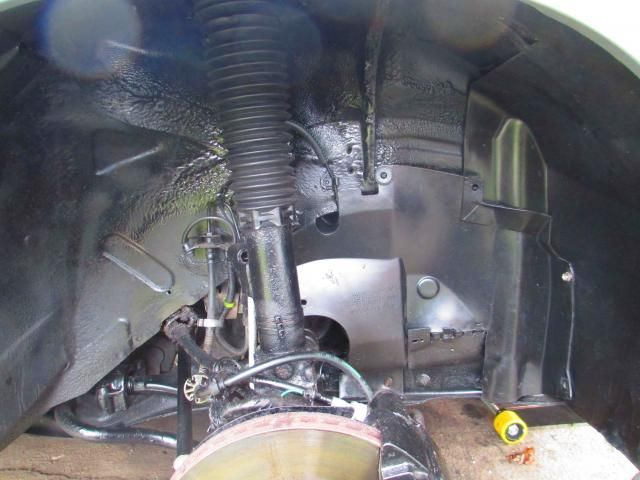

A quick update.....well ive been rather busy with the xm :)
In ongoing preparation work for the MOT test (not yet booked in) ive been rejuvenating it somewhat....
Things that have gone well
New Bosch wiper blades front and rear

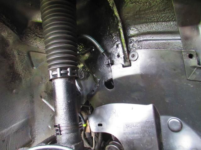

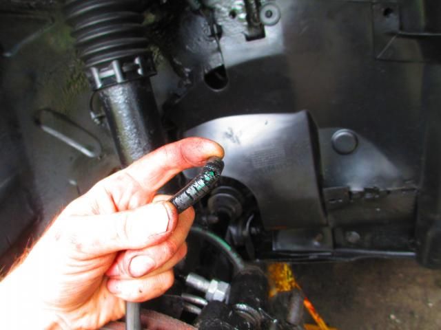

LHM leak in the OSF wheel arch area traced to a split strut return hose. Luckily I still had two new bagged citroen ones as spares, so a new one was fitted.
Down the back of the engine bay from underneath I found a hose of some description where the jubilee clip had worked loose so that was re fitted.
The drivers side outer sill jacking points have been straightened out, surface rust removed and the stoneguard re painted.

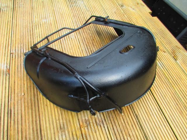

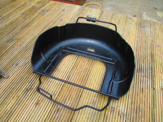

The refurbished spare wheel carrier has been refitted
The rear axle mounts have been cleaned up and resealed to stave off corrosion

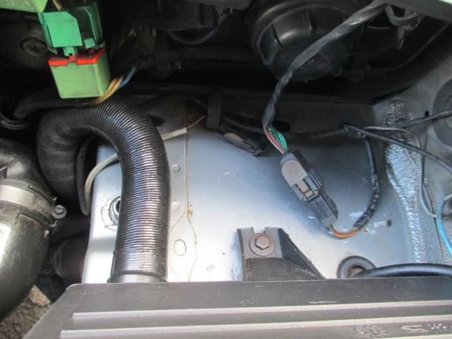

The relays and wiring in the inner wings behind the headlights have been tidied up and pinned up out of the view
Things that didn't go so well
When working on the drivers side sill area the underfloor drain hole looked a bit crusty...so after I prodded it it went through, so I rrmoved the rust metal to leave a nice tidy hole which will now need repairing :roll:
I won x 3 Pirelli p6000 tyres off ebay for cheap money with the intention of replacing one of my front tyres and keeping the others as spares. Unfortunately two turned up down to the wear indicators and the other had better tread but side wall damage where the rim has been bent in through an impact. So all scrap :evil:
Finally the xm ran out of diesel on the drive :lol: Its been a year since ive put anything in it though :|
Oh well, tonight I broke out the steam cleaner and cleaned up the inner wing sections and most of the electrical plugs. I also gave my FDV as light coat of satin black as it was showing light surface corrosion...at least now its moisture proof ;)
So...my next plan is to get a pre MOT inspection arranged to see what needs to be done and then I can get it done....somehow :?

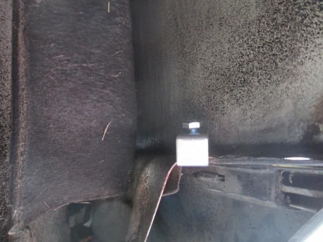

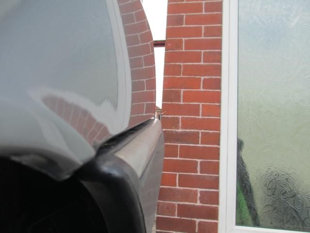

Since I got the car, the leading edge of the nsr bumper has never been secured properly as the bracket has rotten through. Ive pondered many times as to how im going to get it fixed thinking perhaps it will be a garage job....so the other day a thought popped into my head.....
Today I stripped out the arch liner and removed the wheel so I could get access to the bumper mount area. Ive managed to effect a solid fix by clamping the two pieces together with a small universal mudflap bracket. I must say it was a doddle to do and its solid as a rock now :) Its not 100% perfect on the bumper alignment but you'd be hard pushed to tell if you didn't compare it to the other side....see what you think.....Of course a proper bracket fabrication etc would be ideal but I don't have access to that so I have to be inventive ;)

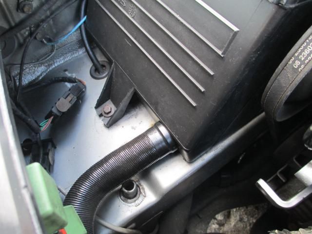

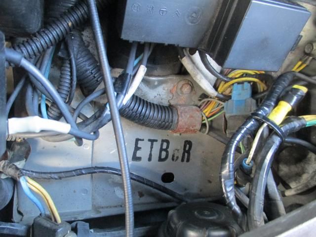

Here are some other pics of recent work done, some refurbed stuff, others results of steam cleaning in the engine bay :P
What does the code mean on the inner wing?...the paint code I believe?
