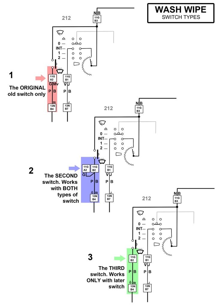

Have already added your page to my circuit diagrams - Old Testament.
Re: Gold 2.0Si
Post by russ92xmsed » Fri Apr 08, 2016 3:34 pm
xmexclusive wrote:
I thought I might ask Russ to turn it into a decently readable drawing.
No problem John. Can do that.

Post by russ92xmsed » Sat Apr 09, 2016 1:48 pm
Is this any good?
Re: Gold 2.0Si
Post by Dean » Sat Apr 09, 2016 2:35 pm
I had an issue when I fitted my car with an intermittant wipe stalk, there was a pin in the switch socket that was moved to a different location, moving the corresponding pin in the loom plug was all that was required to make everything work.
