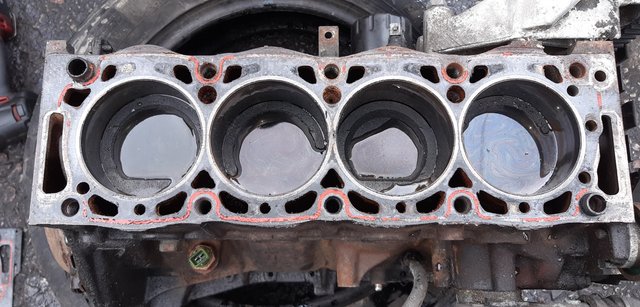

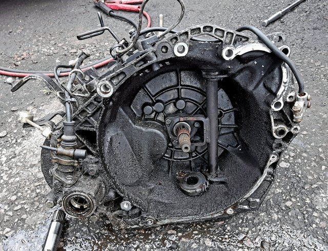

Sump oil filter and pump good, sump all but dry, and the head looks okay at least visually, but the crank is seized solid.
Which is unusual until I removed the box to find it with a thick coating of oil residue.
Removing the clutch revealed a coating of oil leaving me to think the main bearing seal has gone some time ago. Although the clutch was fitted 12 years ago it's still only 15k miles old which doesn't explain why the thrust bearing is almost toast. For the sake of it I'll remove the box from the other engine to see if all's well there.
Head stripped bare and sent for pressure testing and skimming. When that comes back it's time to put it all back together.

I suspect the crank has spun a bearing, is the camshaft Ok.
You can buy the clutch release bearing seperately if the rest of the clutch is still serviceable.
Oem valeo clutch kit is P/n 801001
Release bearing P/n 079937
