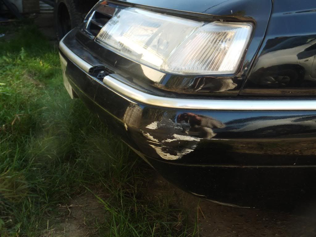

The front bumper seems loose on the OS and has dropped a bit. I don't think the car was like this when I got it and it is annoying me now! I do remember hearing a loud metallic report when on the motorway and only noticing the dropped bumper after this? Definitely further investigation required. also the front bumper is scraped on both sides and I'd like to rectify that eventually (not my handiwork I hasten to add!)-

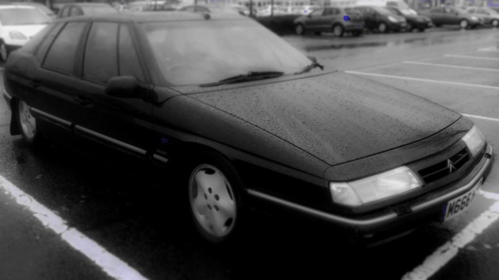

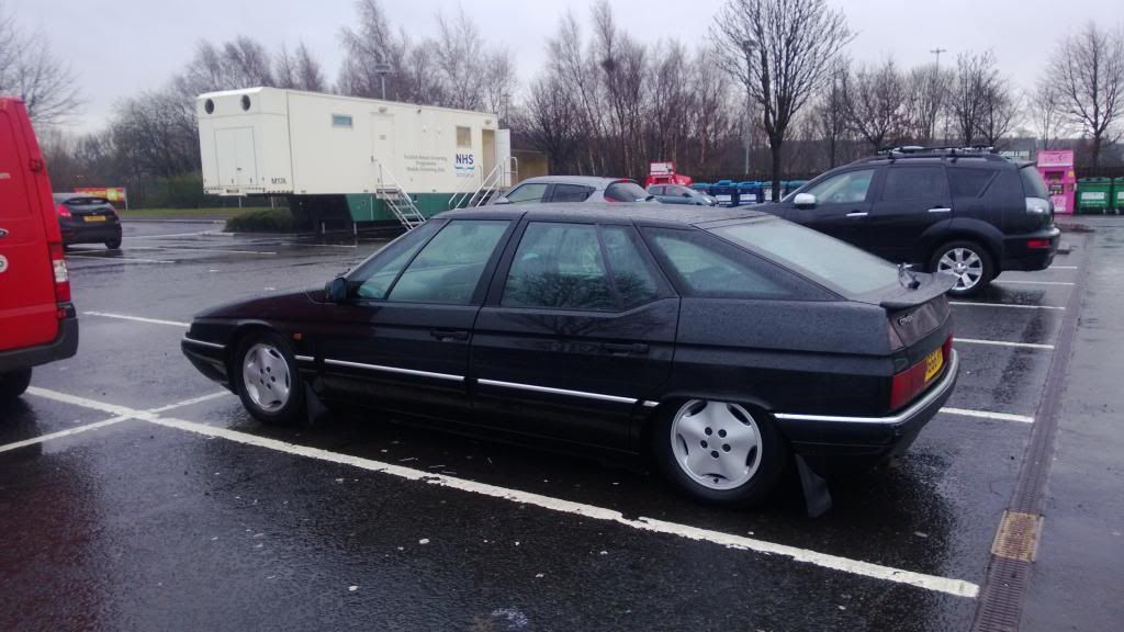

I took some pics that I quite like in an Asda car park of all places.
Even though this one (which was just a test) doesn't show the car properly, it is a great example of why I imagine people on here love their XM- not just for its technical achievements, but for how its design stands out amongst the sea of bland and faceless modern metal that frequents our roads (and therefore, ahem, car parks).
A few more:

I'll bet the front bumper side mount has rusted away... It's very common and not hard to fix either. Have a look at my Presitge blog and you’ll see some pictures of how I let some new metal in on the bad side. Certainly nothing to worry about and besides whilst the bumper is off it affords the perfect opportunity to fix the cruise!

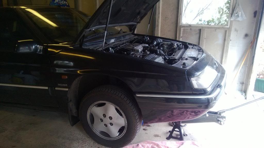

Well at last I have gotten round to the fluid change. As you all know the weather has been diabolical overall recently, I'd been putting it off for ages.
Fluid: Oil was black. :(
ATF was brown! :cry:
Air filter- filthy.
Soon I had changed all of this, fresh oil, ATF, oil and air filter.
The oil filter was quite awkward to get to and I actually removed the plastic pipe that connects to the inlet manifold for ease of access.
Anyway, I'm glad that I finally got this done.
It was also my first good look underneath an XM. I find the underside of cars quite fascinating to look at.
The box changes seem smoother now, I must say.
Now I have the problem of the oil/fuel leak (I'm not sure which). I am sure this is getting worse and need to track it down. Unfortunately I am not really sure where to start. I did previously think this was an LHM leak but have changed my mnd. I made a video of the underside which shows the extent of the problem. The upside is I suppose that the subframe must be getting some fairly good protection from rusting away!

Great to see some progress Rohan, nice work. The gearbox certainly benefits from new ATF.
Don't look too closely at the underside of the XM, it is interesting, but slightly scary!!! :lol:
I tweaked my Doseur Valve yesterday. I ever so slightly backed it off the rubber button to leave a very very small gap. If it is touching that rubber button that bit too much, it activates the brakes. A good sign this is happening is screeching rear brakes when the car rises from rest. Lubricate it too. The pivot point can seeze.
Bit fiddly to do, but worth it. Whilst your there clear out the scuttle, i would. The amount of leaves and composting rubbish that collects in there is quite impressive. Also check drain holes to see if they are flowing and I would as I did yesterday, get to the bottom of the front wings , peel back the wheel arch liner a bit...and clear the rubbish out of the bottom of the sill/ wing. There is a kind of hole that lets the water out, but means everything in the scuttle gets washed down and collects. I suppose if left it'll rot out that area.
That's my suggestions anyway! :lol:
The time has come for me to service mine later this month. Annoying the oil filter isn't like a 2.5. It is literally handed to you on an engine sized plate!! :D
