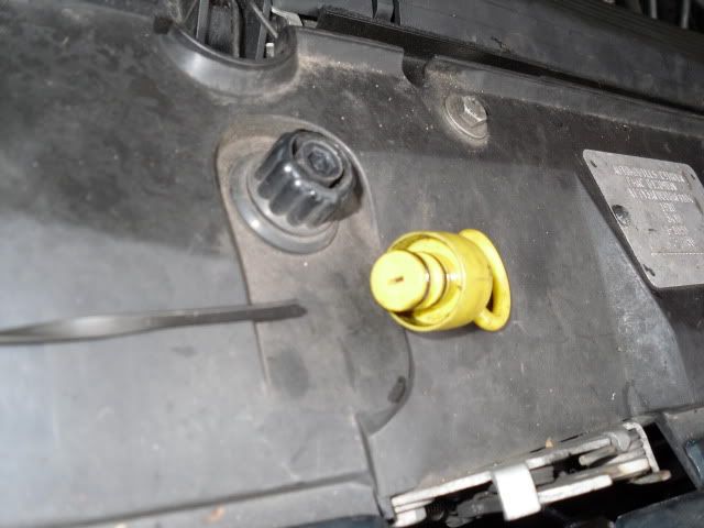

Item one on the agenda had been the gearbox, given that the end of the dipstick was missing, and the ATF had not been changed for some time. Peering into the dipstick tube a piece of metal was visible, which I believe is the edge of the tube into which the dipstick pushes, which is misaligned with the hole in the top cover. I have today dropped the ATF and pulled the gearbox filter, (ATF dirty brown in colour) and found no evidence of chewed up dipstick, so my next mission is to remove the battery tray and pull the top cover from the box, so as to see if I can retrieve the remnants from the tube. Darkness stopped play before I got the battery tray entirely removed, am I right in assuming that the battery tray has some securing bolts accessable after removing the N/S wheel and wheelarch liner?

Im not sure on the other problems so i wont comment but the missing dipstick end is very common, access from the top is almost nill so i wouldnt worry about getting the battery tray out too much, if the plastic insert is not in the filter then the only other suggestion is to take the side cover off from within the N/s wheelarch and see if its floating about in there, its a slim chance but its also the only other place you can access.

Here is the view with the top cover, dipstick guide and valve block removed, there is no way of getting into the bottom of the box from there. I would give it an oil change then wait a few miles and change the fluid again, check the filter and if it hasnt appeared you must assume it has been fished out in a previous oil change by a previous owner :?

Thanks Dean, I'll try and get a photograph tomorrow, but my other motivation for taking the top cover off was that the dipstick guide tube *seems* misaligned with the top cover. I first thought this was part of the broken off dipstick, however it does not match the handle in terms of shape, and I don't see how it could have been just suspended there. I might be able to bend it back with a tool, of somekind, but was really wanting to do this with the cover off so as not to chance wrecking anything. Perhaps I should see whether the new dipstick fits straight in before I go too mad...

Ah, what colour is your handle? if its orange then the dipstick will have a flexi coiled wire body with a short black plastic insert in the end (which drops out) with the level markings moulded on it.
If the handle is yellow then it is constructed the same as a normal engine oil dipstick and dont usualy cause any trouble (fingers crossed). Its the earlier orange type i was refering to in previous posts by the way and they are both about 12" long, if yours is missing everthing then you may have to try and find it from the top with a magnet, its an easy job to get the valve block out and i have plenty of photo's if you need a refernce.
The guide tube is fixed to the valve block via a small bracket with a 10mm bolt and is totaly seperate from the short neck in the top cover so this is very easy to adjust by just removing the cover although it depends how much coolant and boost piping you have to remove to get that far i suppose.

Ah balls, I do have the yellow handle but nothing else, so it would seem the rest is stuck internally, perhaps dislodged due to the guide tube having been misaligned during a previous repair. Never mind, the top will come off tomorrow, and hopefully something magnetic will give me a result without too much dismantling...

Here's some photos I've pinched from Lez's thread (where he performs that great save on his autobox). I think it shows the guide tube that Dean is describing and that both you and I think might have been 'crushed' when the top cover was replaced previously. It looks likely that is what we could see (somewhat squashed) when the 'stub' of the dipstick is removed doesn't it?
Second image shows the tube - directly beneath where the dipstick was in the fist image.

Hurrah! I've had a terribly sucessful day. I bit the bullet and stripped out the battery tray, and removed the lid from the gearbox. Lid removed, it was obvious what had happened
The dipstick had been entered at an excessive angle, which had allowed the stick to pass between the gearbox lid and the top of the dipstick tube. This served to bend and distort the dipstick tube, and ultimately as it was forced home, caused the blade of the dipstick to snap off. Luckily I found it still standing up next to the dipstick tube, and it was easily lifted out.
