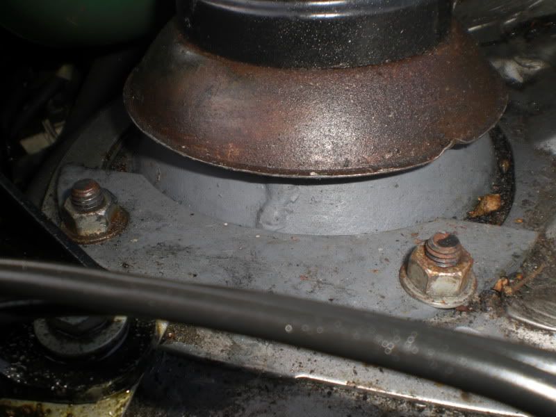

Hurrah! At long last I've taken the photo. So, the new part is all in grey. It came in two halves. In cross section it's a bit like: _/ \_ as you'd expect. The oblique sections are actually conical - not flat. It fits under the chassis. The two halves are then supported by the 'closing' brackets which fit on top of the chassis. I've also welded the two halves together. According to the chap who sold them, it wasn't scrictly necessary to weld, but it does help.
At the time of welding, the Gorilla Glue wasn't used, so the new strut top as still loose from the original Cit part that glues to it underneath. This meant we could temporarily slide a heat reflective fibre glass cloth between the strut top and the rubbery part underneath to prevent damage due to the welding heat.
They seemed particularly well made, an engineered solution rather than an ill fated attempt and I have to say that they do their job perfectly.

Thanks for posting the photos and explanation.
The gluing is important in case the rubber cone parts completely from the original metal cone.
Seperation in that manner is a real risk on the shaker rig and visibly obvious.
Such seperation is an automatic MOT failure.
Without the glue all that is being fitted is a form of Pop-up restraint.
How much were they?
Last price I had for this system was £120 per pair plus postage and vat.

From memory I think the quantity of Gorilla Glue was small (seemingly sufficient), but I agree it's key.
£150 springs to mind but I can't remember if that was all in or just for the items themselves

Thanks for that Geoff, that's how I remember them to be. They do look substantial and well made, do you know the thickness of the steel?
The original plates are 3.5mm on the ones I have, can anyone measure theirs to check that.

I'll have a measure, from memory and assumption 3mm, but I'll check
