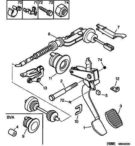

I have it on some authority that the part number is actually 21 50 J6, is there someone on here who can confirm?
Also as I understand it, the clutch cable comes in two parts: the bit that goes under/behind the dash (the bit you don't want to fail I imagine!) and there section that is under the bonnet so to speak. Am I correct, in which case does anyone know if the latter section is interchangeable with LHD ones? Ta, Phil

Phil,
I think you need :
2150 J5
- INJECTION TURBO XU10J2TE ET BVM ME ET CONDUITE A DROITE
They don't make the J6 variant anymore.
2150 J6
NFP
- INJECTION XU10J2 ET BVM BE3 ET CONDUITE A DROITE
The cable is 1 part as such, but there are 2 cables and a linking mechanism in the middle. Its the linking mechanism that broke on my pal's car. I'll see if I can get a picture for it. His one broke on the link part.
I think you need :
2150 J5
2150 J6
NFP

Re: Clutch cable
I cannot speak from experience (touch wood) but I thought that these self adjusting cables failed as a result of the self adjusting mechanism giving up the ghost or failure of the plastic quadrant (which turns the clutch pedal motion through 90 degrees and sits just in front of the bulkhead). On my 2.1TD I always keep this quadrant smeared with grease to minimise wear on the two 'eyes' in the plastic which hold the cable nipples.
Has anyone ever experienced a truly snapped cable?
A LHD clutch cable must be a much shorter and simpler constuction due to its location directly behind the gearbox.

- Posts: 4002
- Location: Charmouth, Dorset
Re: Clutch cable
Yes I have. On a Mk 1 2.1, it snapped at the nipple in the pedal. That's the only one though in about a quarter of a million miles
