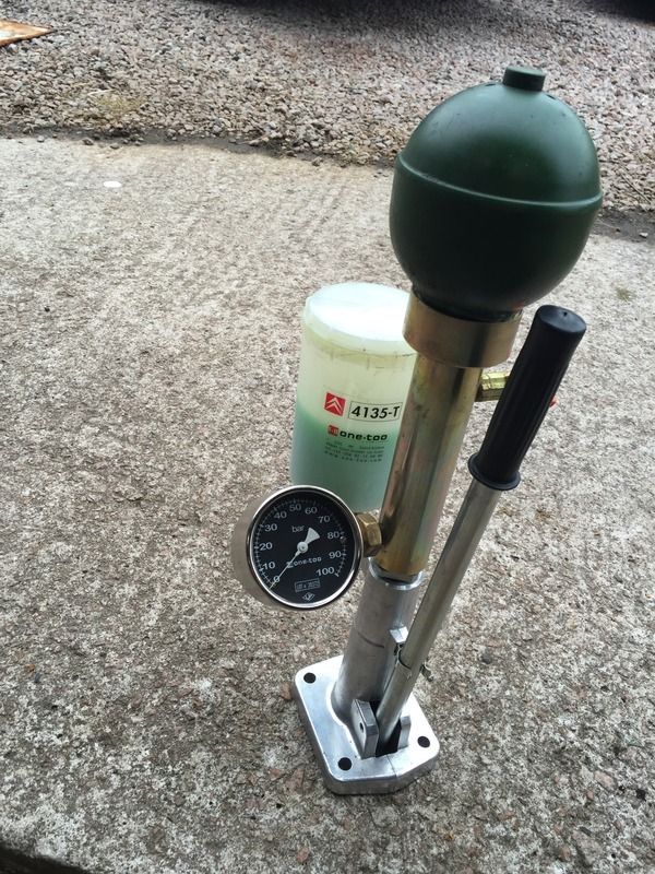

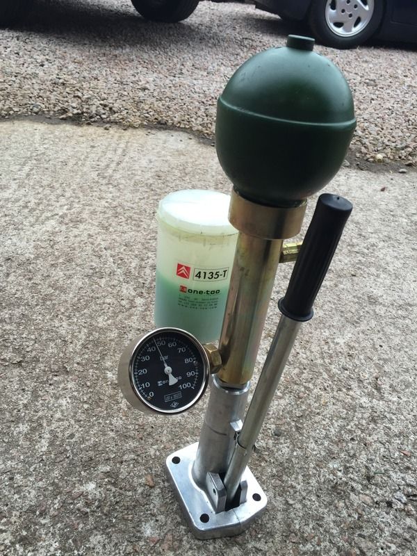

Well, last week I finally managed to find the holy grail!!
I was talking to LCS in Louth about the sphere recharging valves they were selling. I said to him "I don't suppose you've got a pressure tester do you?" When I was speaking to him he said that they didn't. 5 minutes later the phone rang and he said he'd got one. It was brand new and had never even had a drop of oil in it!
It turned up last week but I didn't have a chance to get near it until today. They're very simple really, but it's great to finally have one. I almost felt bad filling it with oil really
The sphere I've got on it at the moment is just one of many that was in a pile I had. The tester stops reading at 45 bar, I've no idea what it should be on that sphere, however, it's got 45 stamped onto the side of the sphere so I can only assume that this one is very good.
Paired with the sphere recharger that I won on eBay for a tenner last year, I'm all geared up and ready to go now!!

Hi Will,
It does indeed use valves.
Here's a few more pictures of it:
I've had a price for a 6 foot cylinder of Nitrogen as well. £90 inclusive of VAT and I can keep it for as long as I need it. The cylinders are pressurised to about 250bar so should have more then enough pressure. When I get round to it, I'll get the cylinder and then line all of the cars up to recharge them all during a weekend.
David.
David.

You won't need a six foot cylinder, as standard size one will be more than adequate as you will need about 100cc at say 60bar, per cylinder. Is that an Argon cylinder in the photo, if so, use that as Ar and N2 have almost identical molecule size and compressability.
N2 is used because it's cheaper.
I always thought those valves were just replacement plugs with flats on, the way they fit the adapter is very alike the original Valprex valves.
Re: Wanted: Sphere Pressure Tester
Are those valves still available from Citroen, David?
The sphere tester looks a splendid piece of kit. How do you operate it?
