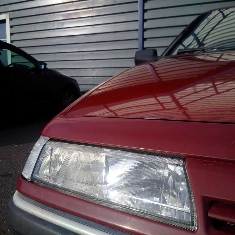

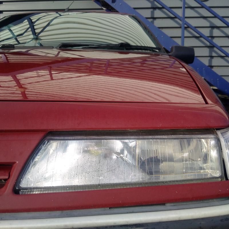

Took the lights out and apart for cleaning yesterday. What a difference to the light output! Must have left a bit of water in the left one though as it's got a bit of mist in it.

XM lighs suffer terribly when the reflectors are dirty. A clean out and polish of the fresnel makes a tremendous difference.

Fresnels were the wrong way round. Wish I'd done my research and read about the peroxide to remove the yellowing as you recommended.

Simple t-cut can do the trick too. The peroxide only works in strong sunshine, but it is the gentlest way of cleaning them.

Those fresnels look pretty good now.
T-cut, and Mer, have worked for me. The yellowing is chiefly at the surface, and can be largely polished out if not too severe.

Afaik, the yellowing is the UV coating applied to the fresnel lenses, no the actual plastic. Abrasion removes the lacquer quickly.
