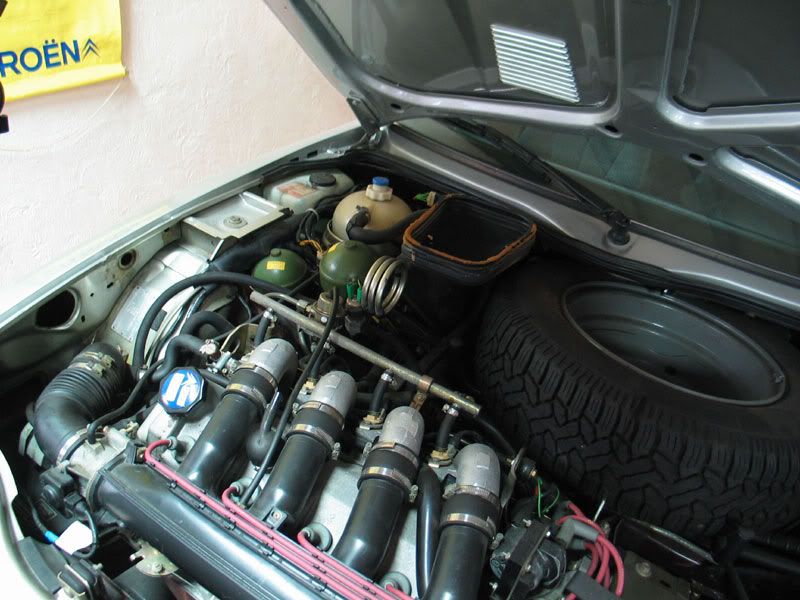

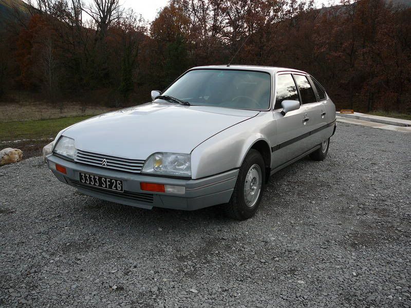

- Posts: 1098
Re: Spares, on IOW!!
100% Correct!jorgy wrote:like "CX Regamo" or smthing
It was indeed called the "Regamo" and from the (IIRC) 12 that were made, only two are known to have survived. One is with Citroen in Paris, while the other is in a private collection called "Citromuseum" also in France. It was called the "Regamo" because the "Reg" part stands for "Regulation", and the "AMO" part stands for amortisseurs (suspension dampers). 6 of the cars were kept by Citroen themselves, while the other 6 where sent to dealers for testing. After this, they leased them to high mileage drivers and after 30K they were converted back to standard and sold on as 'normal' CXs.
As for layout, the main mount is under the bonnet and on the right back chassis while the control unit lives to the right of the steering wheel and the computer is under the right seat.
That's all the info. that I've got on it, and here's some pics that I found too:
