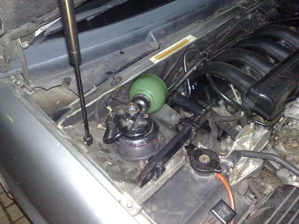

Had a visit from John....xmexclusive this evening bearing the gift of a new strut top. And mightily impressed I am aswell
Big apologies John, got carried away with chatting didn't even offer you a cup of tea.
So 20 mins after john left Bernie, my XM has had his hip replacement, used it to go to work this evening and what a difference, the old mount was obviously dodgy for a while the steering tracked nice a true and the power on/off steering it showed has all gone.

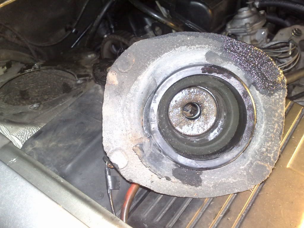

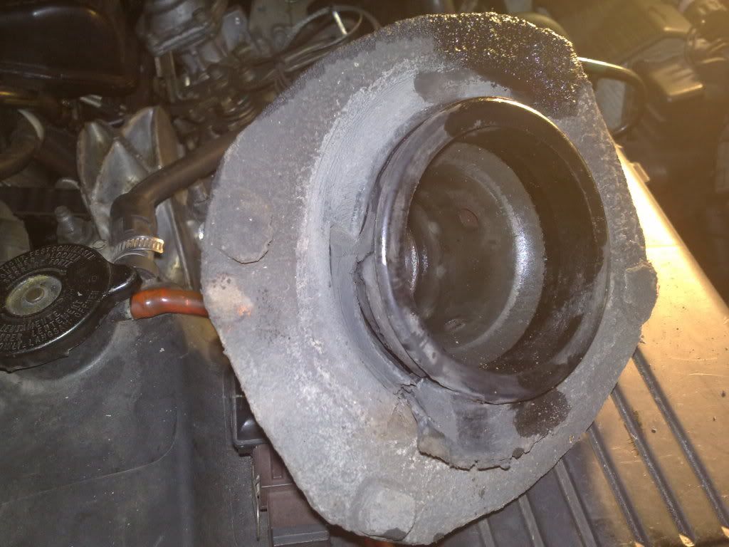

Anyway a few pics, first 2 are old mount you may be able to make out the splits

Looks good, please keep us informed.
Those splits don't look too bad...

They looked a lot worse in person. not a great deal holding it together
Seems the photos have been cropped a bit when they attached, I'm not as bad a photographer as it seems
There was lots of play in the mount when taking it off, and reversing and braking caused the sphere to hit the bulkhead.

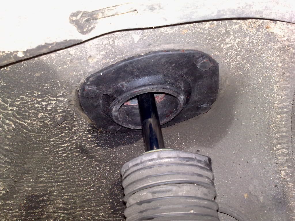

Re: strut top
They are perfectly FINE compared to the two I took off my 2.1 SED.... When i was removing my tops the metal part for the sphere mount was movable in my hand! Ive taken a video of this to show how bad...
Infact the top had popped slightly and was resting on the Lip just above the sphere (Drivers side)
Unfortunally, bad weather and lack of time has frustratingly put a halt to my resto work..
