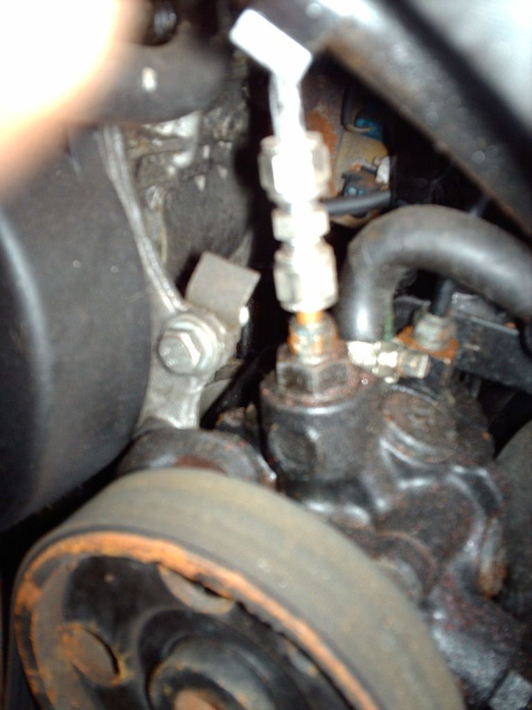

I personally feel the cheapest/quickest/safest way forward is to use a 'Swagelok' connector , I've actually got this type of repair on my Xantia (Which was done prior to my ownership) see below :-
Also see THIS thread/posting, for a previous forum members similar problem/dilemma
In the past when I've tried sourcing these fittings with local suppliers I got no joy, Also the main UK distributors weren't too helpful either !
So now I hear you 'Thinking' where the hell can I source one of these connectors
However your in luck on this occasion (Purely to timing) as I've found some on E-Bay !
If the split/rupture is just in one place (hopefully on a straight section), as in my example Xantia photo /\ .
As that has a 6.35mm = 1/4" dia. pipe it the same as your 2.5 TD feed-pipe, STRAIGHT-CONN. and if you need a bend ELBOW-CONN. (albeit only 90 deg.) , so for £6.20 (Straight) or £9.50 (Elbow) you could be back XM'ing again soon
I hope the /\ maybe of help to you (and others) , A beer @ the CXM meet would be appreciated though !
