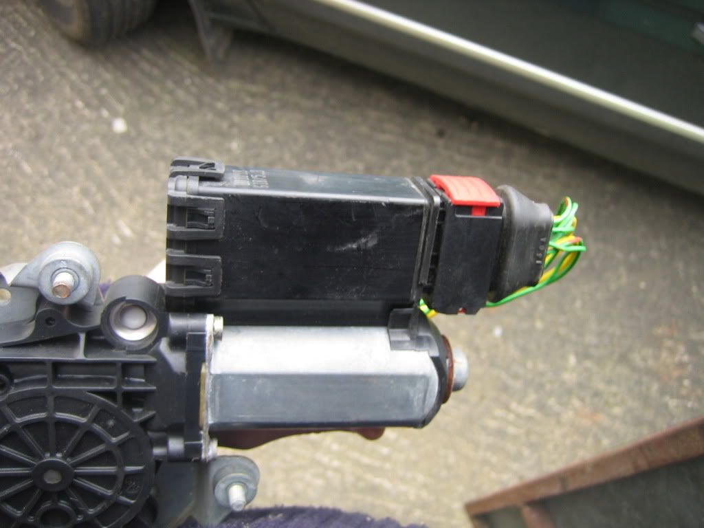

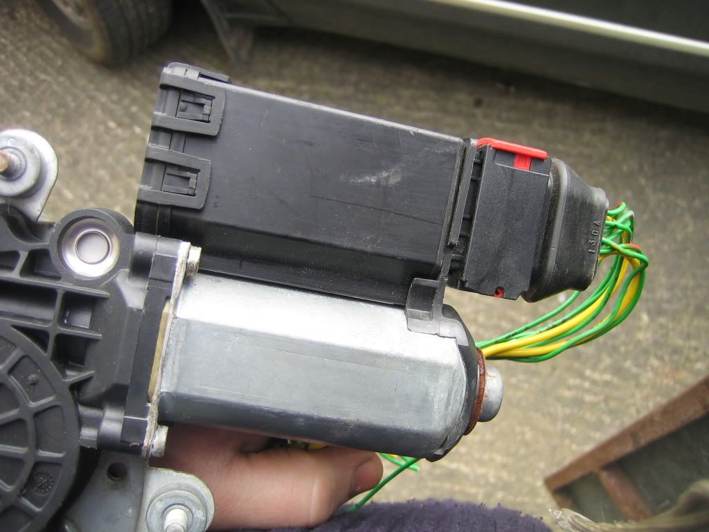

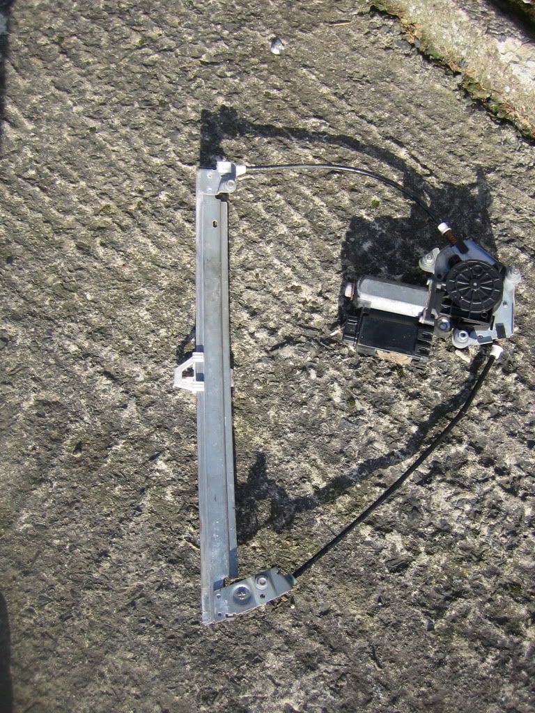

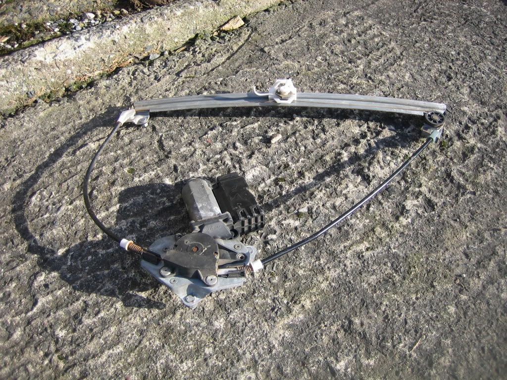

Its high time someone could start a 'FAQ' - 'Sticky list' (As I've already stated on many of occasions) and IMHO the '9-pin' drivers door window regulator problem should be nailed with a 6" nail at the top of the list :lol:
bobtee wrote:Hi john yes my car is as you describe, my socket is one row of 5 pins and one row of 4 pins its a bosch fpg 12v 0 130 821 668 ,sorry whats WHMs thanks very much for looking and the reply Bob.
Bob, if you read thro' the links below (Including the links within) it should give you (and others) a comprehensive overview of the common wire failure problem !
Links:- # ONE, # TWO and # THREE
All we need to know if yours is the early type with the S/S clip type connector plug or the one with the Red 'Cam-lock' type which where fitted to the later models ?
Johns ref. to WHM are sellers/breakers of XM's, I've checked WHM's E-Bay listing and they have no 9-Pin types listed, but I have a an earlier S/S clip type connector plug, window regulator available !
So just in-case you missed Roberts E-Bay link (With Photo's), within the forum thread links /\ and for everyone's convenience, I've copied Roberts photo/links into this post (I hope that's okay with you Robert ?) if so don't delete your 'Photo-bucket' images ;)
EARLY S2 - 9 Pin Window Regulator :-
LATER S2 - 9 Pin Window Regulator :-
I hope the /\ will be of help to identify which one they have (If not now possibly for future ref.) !
