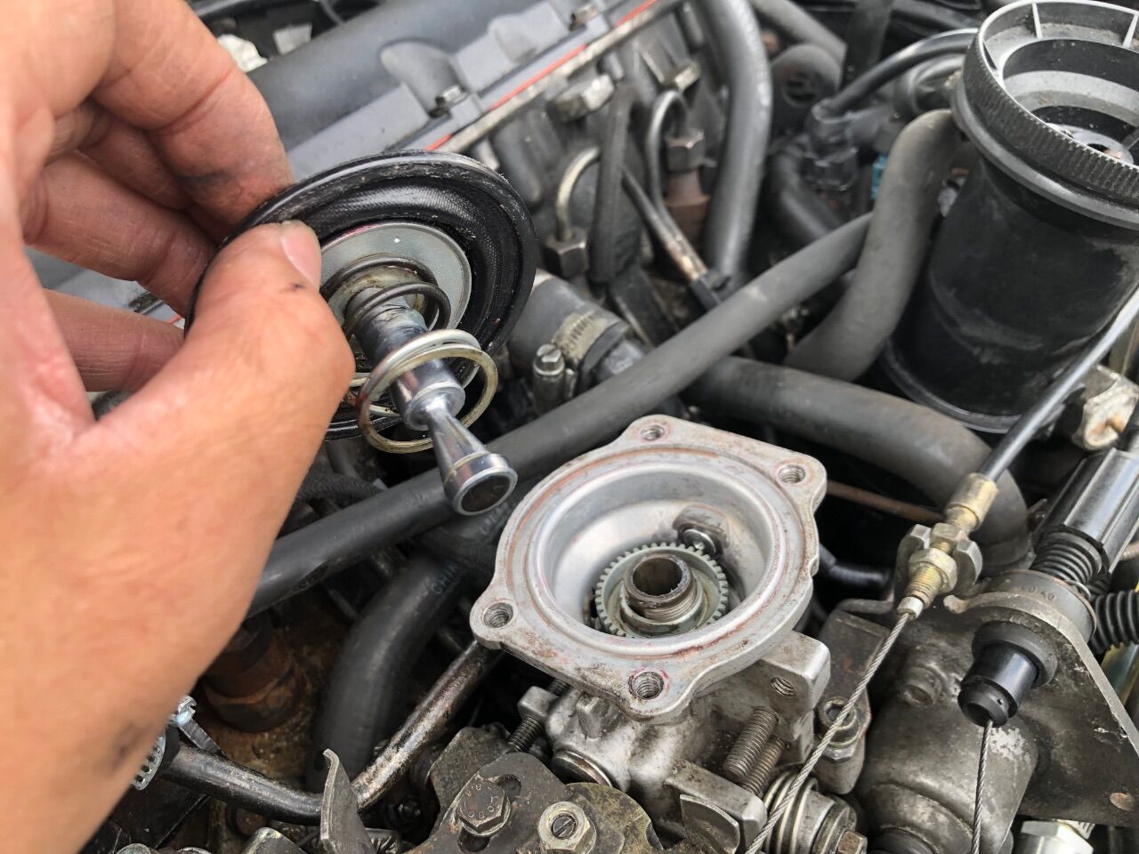

Nice strip-down of the diesel pump, all the way to the vane pump. You can replace the metering head O ring without removing, or dismantling, the pump; simply remove the injector pipes and loosen the metering head enough to sneak the O ring out and a new one in.
Thank you - I did strip it to a bare housing, but forgot to take a photo of this stage. I actually found it very enjoyable to strip and rebuild, I like jobs like that, I'd happily do that job again rather than continue to work on the ABS wiring.
I did consider swapping the o ring in the way you suggest, but I've had a series of leaks from this pump and decided that it was for the best to swap out every seal for new. I was already doing the timing belt, so it wasn't much extra work to remove the pump.

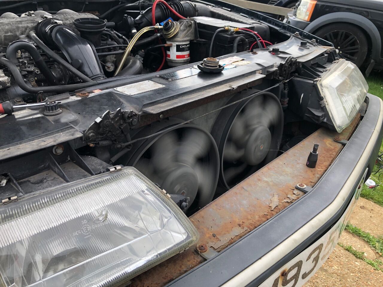

Cooling fans coming on indicates an issue with the Bitron fan control, either the controller, wiring, or sensor fault.

I forgot: for the cooling fans to be stuck on low speed, it could just be the relay has stuck closed, possibly after a low voltage situation has caused arcing.

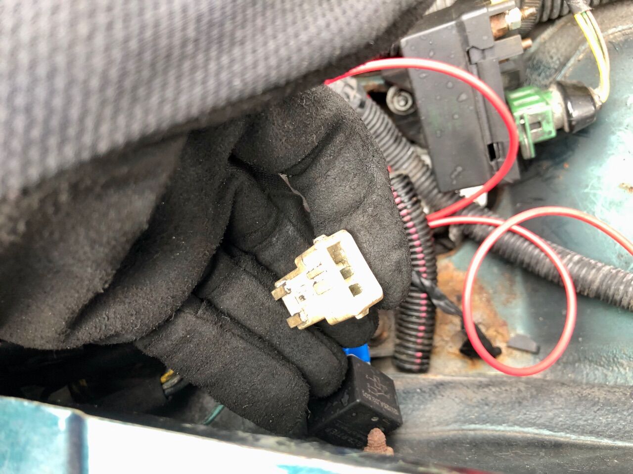

Good news - I've found the issue with my ABS system. This connector beside the fusebox had broken down inside and is producing a very high impedence:
I only discovered this by back-probing the loom at the ECU end, and I could see the voltage was collapsing when the circuit was made. I checked and confirmed this by making up a test lamp and using it to test the power feed with the ECU removed: +12v without a load, 0v when under load. I then made a jumper lead so that I could provide +12v to the ECU to test there weren't other issues, and with the jumper lead everything worked.
I've cut out the old connector, and replaced it with a new waterproof connector.

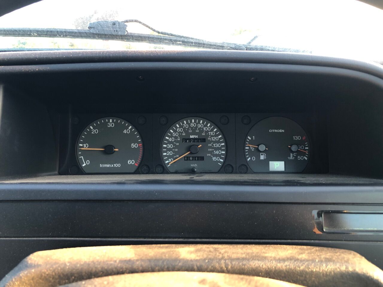

The ABS light now comes on, shows the self test flickers, then goes out. It's nice to not have that lamp permanently lit up anymore!

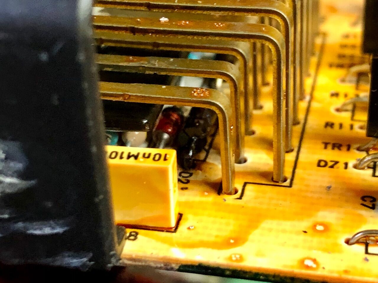

I found the Bitron box in the driver's footwell. I disected it, and found that one diode was scorched and a few others are dead
I'll try and get round to removing and replacing those, although annoyingly the scorched one is under the legs of the connector.

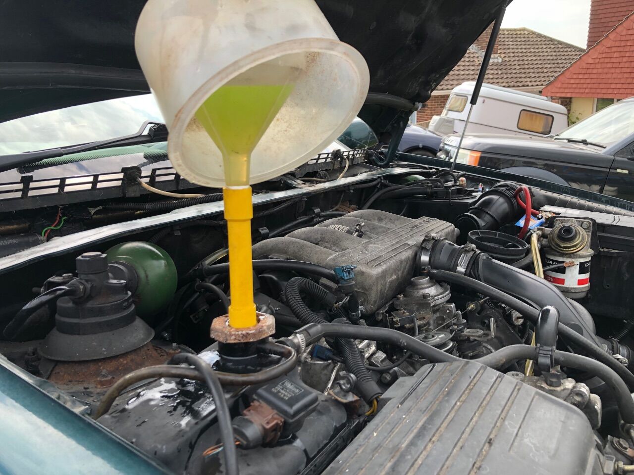

I then finished putting the timing covers back on, engine mount, and cooling hoses, radiators etc. that I'd removed when following the wiring loom. After that I filled the coolant:
This would have been a perfect job for my spill free funnel, but my son broke the funnel part when I left it in his reach a while back. Luckily the adapters were still usefull, and the bedge job I made from those and another funnel didn't leak that much.
The bitron box is temporarily installed, and I ran the car up to operating temp to let it self bleed.
All seems good now - the new thermostat has made a brilliant improvement to the warm up time and running temperature of the car.

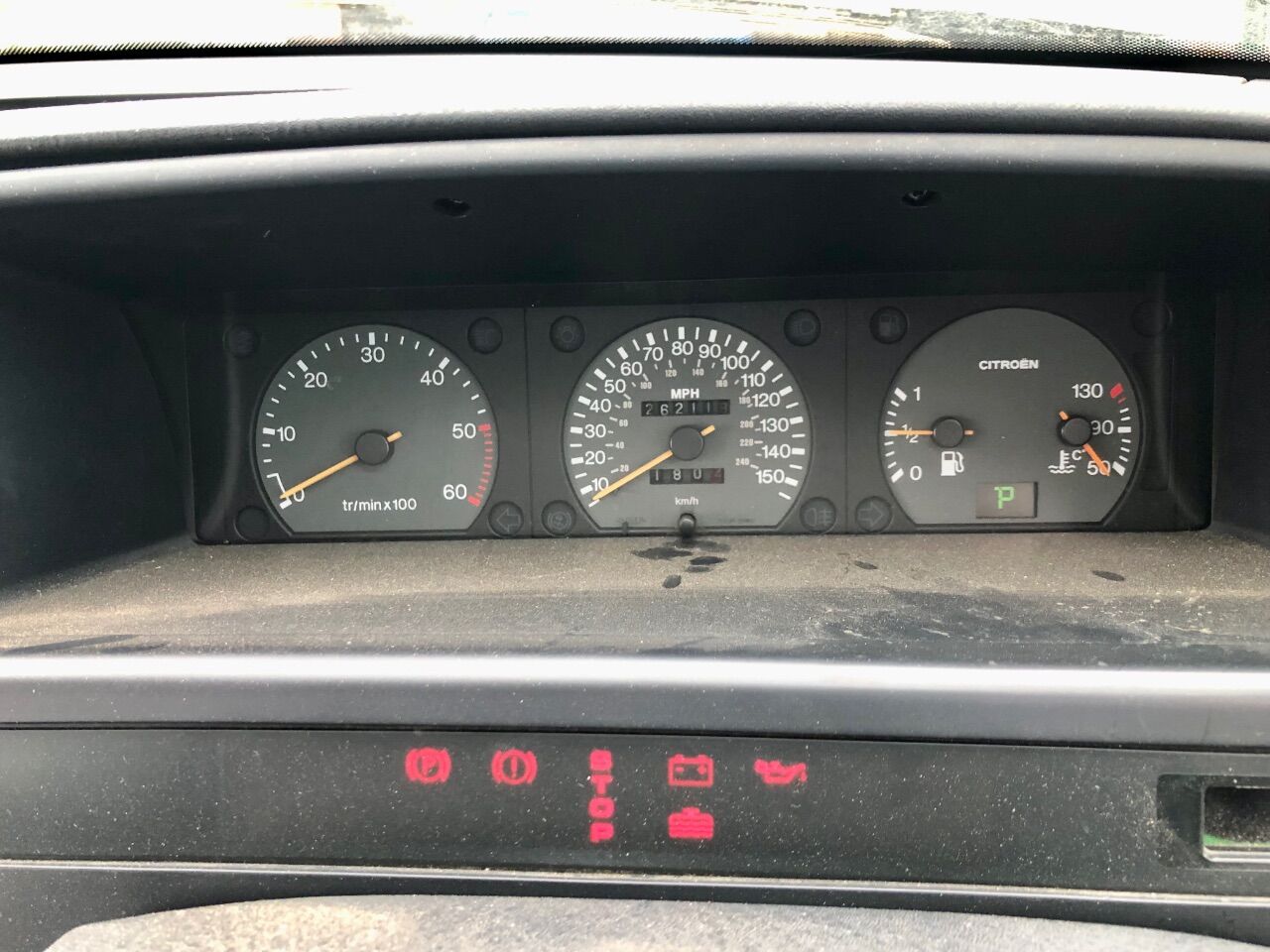

There we have it though, a happy car with a clear dashboard for a change:
Albeit not for long.

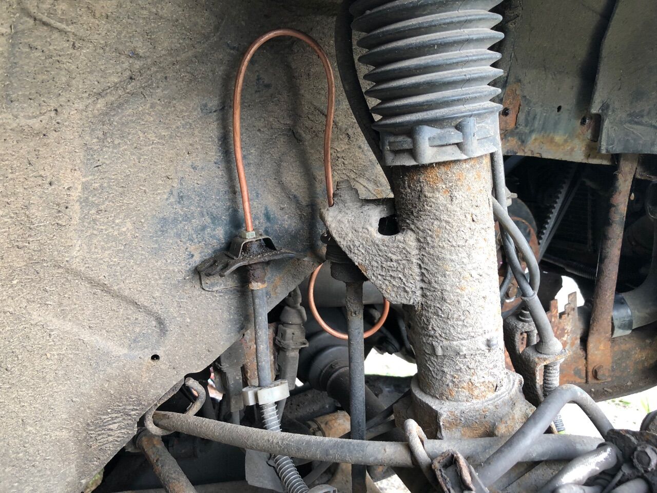

The offside front brake pipe burst on the way to work the day after the car was 'finished'. I limped it home using the parking brake where practical (I was only about half a mile from home). The pipe must have been at the end of its life anyway, and my work in the vicinity has tipped it over the edge.
I've put the car back on stands and I've started stripping the old brake line off, and will replace it over the next couple of days.

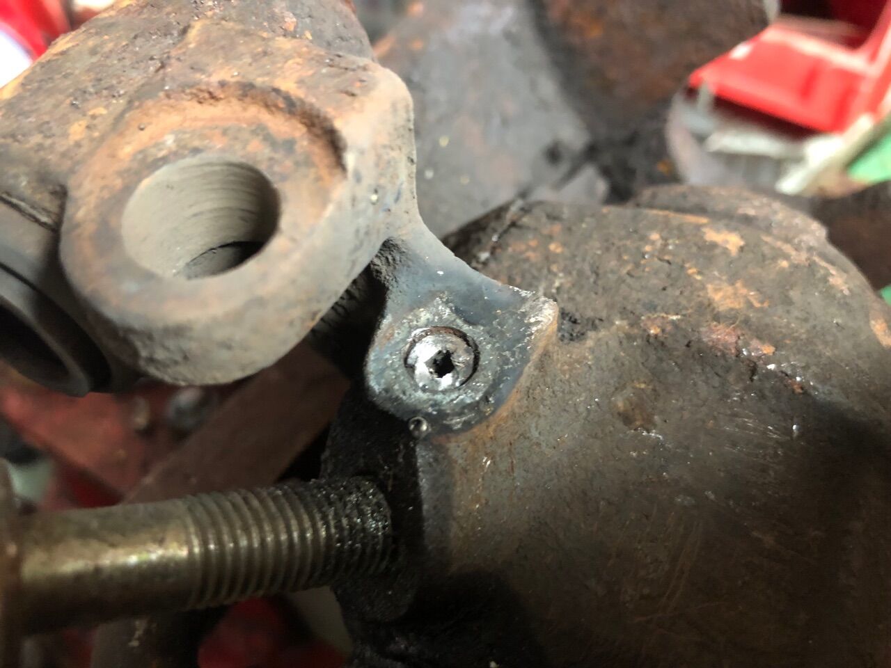

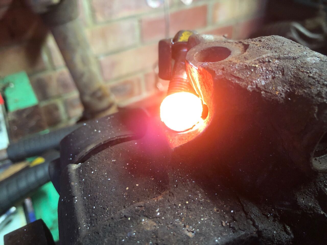

That said, I of course have to sort out the blown brake line. I got the old line out this evening, and made up a length of brake line to 2.4m which was what the part catalogue suggested. I then started from the ABS pump, and bent the line in situ. Not the prettiest, but it used the factory clips where they are still present. I had to lose a bit of length at the calliper end, but there are no clearance issues fortunately.

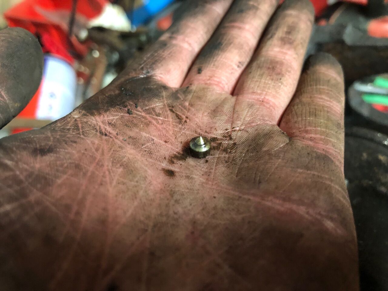

Despite taking care, the bleed screw on the calliper sheared.
Welding did not save the day, sadly.
Surprisingly, patient drilling did save the day.

Nice job on recovering the bleed screw.
I'm not surprised it sheared, it does look pretty rusty. Maybe giving it some heat, a few hammer taps straight down, or inserting a drill bit prior to unscrewing, may have helped.

Thank you, it was a relief once I got the screw out and saw that there was no damage to the calliper.
The access when the calliper was fitted to the car was poor, I did try to get some impacts on the screw before undoing it but I just couldn’t get much of a shock into it. I gave it a belting with a punch before I welded a washer and nut on it, and nothing was shifting it; I think I was set to lose from the start on that one.
My partner is picking up some bleed screws for me on the way to visit her friend, so hopefully I’ll have this sorted after work today.
