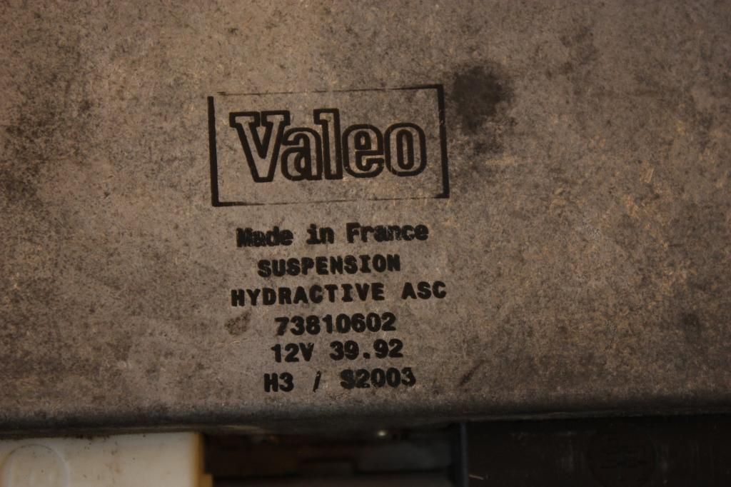

Did you ever fing a spare 'H3' Hydractive ECU? With the help of Chris and John I think I might have traced the fault in the suspension (at least narrowed it down)
I am pleased that you have the headlight glass Graeme and if you could confirm the H3 ecu number I will check my spares. With regards, Matthew T.

Hi Matthew, it's Hydractive 1, H3 ECU (I think if it says 'Valeo' and 'H3' on it then it's the same one as I understand the final version of the Hydractive 1 was named H3 - 2- plug type, one black, one white) Got a picture somewhere

And if not, anyone else got one of these? Ideally known to be ok but we can go with anything!
- Posts: 5925
ECU's marked H2 or H2B are pin and function compatible with H3 ones.
Casing of these is usually black paint not silver metal.

Thanks John, that's good to know

In my collection I have a H3 hydractive ecu in silver to match yours Graeme, apart from slightly earlier numbers of 40.91 and S2001. Please send me a PM if you would like the part. With regards, Matthew T.
