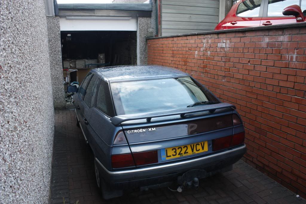

But the jobs working on the car at my parents' is a pain as they're having a major refit done in the house I'm out in all weathers with no moving space - it was icy sleet and puddles when I started working on it earlier, finally cleared up a bit later so I took a few snaps.
Narrow driveway and garage full of stuff

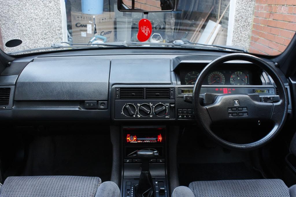

Interior after the front passenger seat work

That dashboard is looking a bit shiny, it would be worth going over it with a damp cloth to knock it back a bit.
Overall, it's a lovely car and a great colour.
Re: My 1993 XM 2.1 SD Auto L322 VCV
Mmm agree, can't stand that shiny silicone spray stuff.
But Graeme, I do love the colour. It's looking great. Well done with all your fixes.
- Aerodynamica
- Posts: 705
Haha, yes it looks it but I think it's down more to my crappy photography skills not metering it right! still, you can see the footwells though! It's not a very reflective dashboard in use I find. That said, in over head sunlight I do notice the smallest flat surface of the instrument 'hood' reflects in the windscreen so maybe buffing up that bit at least would be beneficial.
