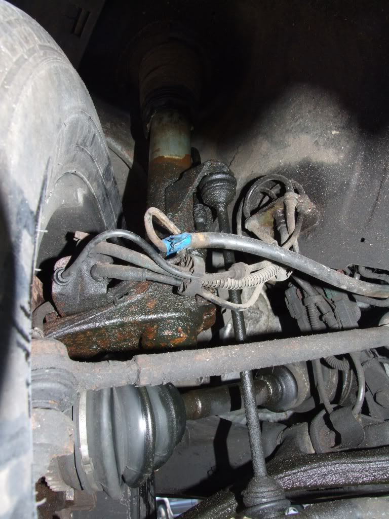

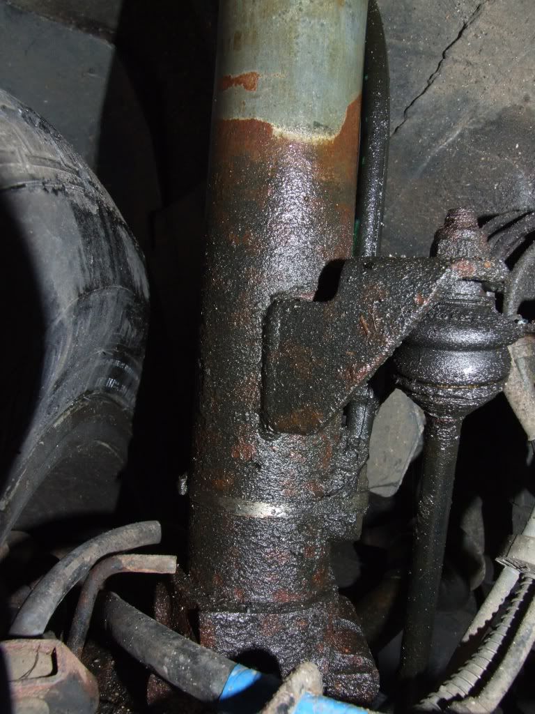

But the real sting in the tail, is what I found this morning.
I had to move the car forward for a neighbour yesterday, and in doing so revealed a lovely pool of oily liquid, and quite large. I brushed it off as water mixing with the oil in the sills, and as it rose...back first,.... it poured it out onto the road. However this morning, I checked behind the passenger front wheel and a little pool of oil was present.
About a 4x4 cm. So it looks as though it has decided to have a secret wee somewhere..
I drove a short distance to get the tyres some air. Absolutely nothing to report gearbox wise, brakes or suspension. All as normal. No grinding or metallic noises. And where it is parked now, no drips and no puddles. However it is oily...So I am wondering this. Has a CV gaiter split maybe ?. Only I have noticed the steering becoming a little vague at times. By that I mean some play in it.
Pics below. Sorry, i'm not great at diagnosing things like this!
I'll also post in the relevant section too.
STOP PRESS>>>I HAVE JUST NOTICED THE GREEN DRIP ABOVE THE DRIVESHAFT ON PICTURE 1 & 2.. TOP LEFT HAND CORNER.
MMMMMMM.

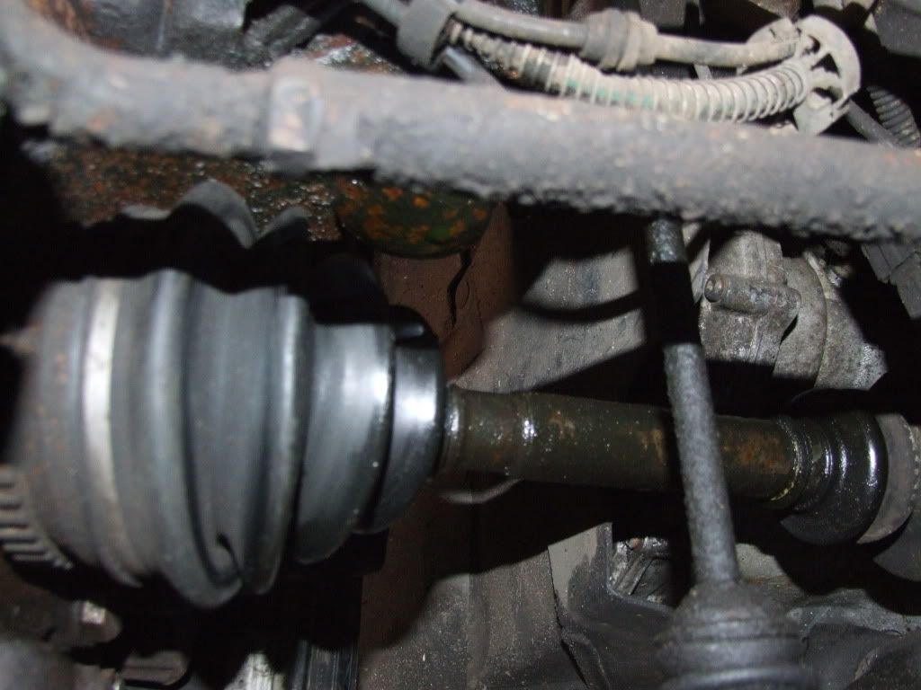

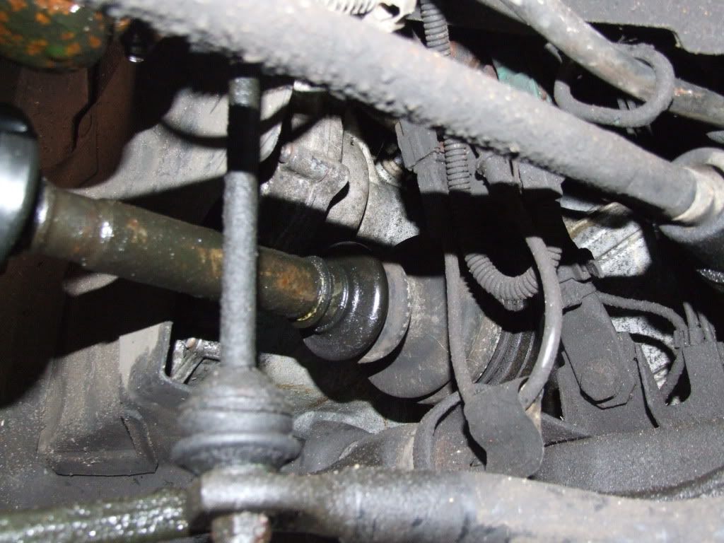

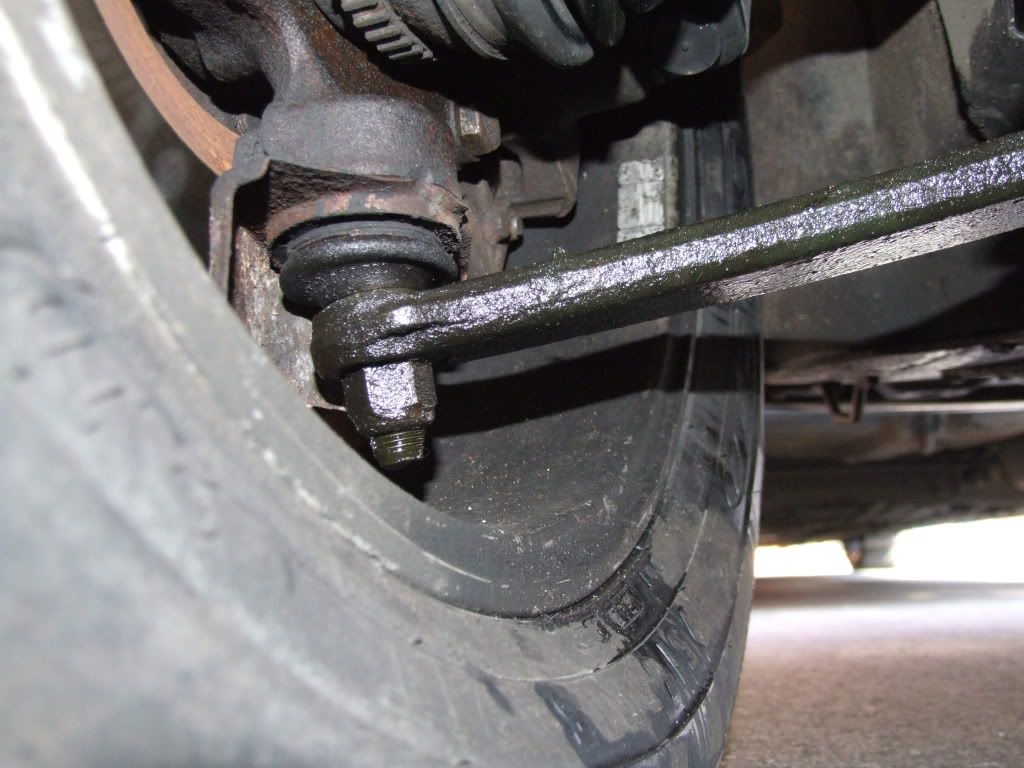

More pics. It is now a Hydraulic problem. Possibly Fluid return hose. But not sure..any one any ideas? Out of my depth on this one!...no change there then....
I checked the LHM levels and it was low...on the bottom red ring infact....not surprising really. Topped it up so should be okay for a little while. But this needs sorting out ASAP.
More pics in the Hydraulic section. can't be bothered to do the clocks today. I'm miffed!
