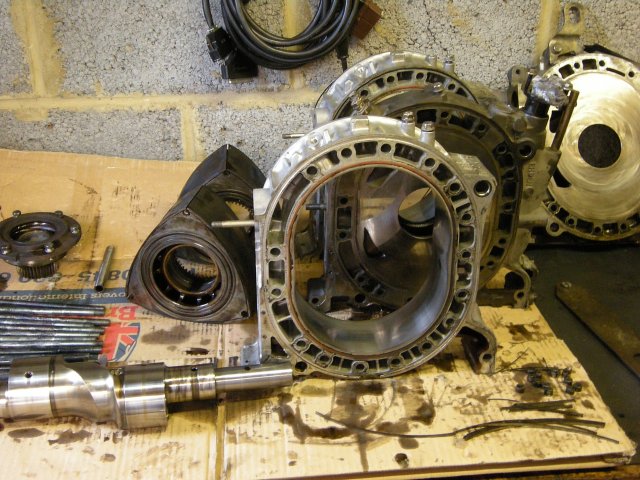

Chris570 and Liam (RX-8 owner) made an appearance clutching a massive impact gun to make an attack on the previously unmovable crank bolt on the RX-8 engine.
It did nothing. The bolt remained unmovable. We tried heating it with propane until smoke issued from the crankcase. Still no go. Then I cracked out the oxy-acetylene gear and did as we had seen advised in some forum posts on this very problem - heat the bolt cherry-red.
This we did and it came off without a fight
Twenty minutes later the engine was entirely in bits.
Here it is:
The news is not good. The engine is basically scrap. One of the main bearings on the e-shaft (crankshaft analogue) failed catastrophically. You can see the scores on the journal quite plainly and this allowed the shaft and rotors to flail around. Apex seals broke and worst of all the front rotor crashed into the side plate and has ruined it. In fact all side plates are badly worn.
This is the worst one:
In fact the only serviceable items are the things we thought would be wrecked - the rotor housings. Although not perfect they might just do another tour of duty but there's no way anything else in the engine will..
We're not sure what caused the failure. Possibly it ran out of oil..
Parts to rebuild would be more than a new engine... Liam is now wondering what best to do. Tomorrow we're going to measure up an ES9 engine as a possible transplant candidate...
