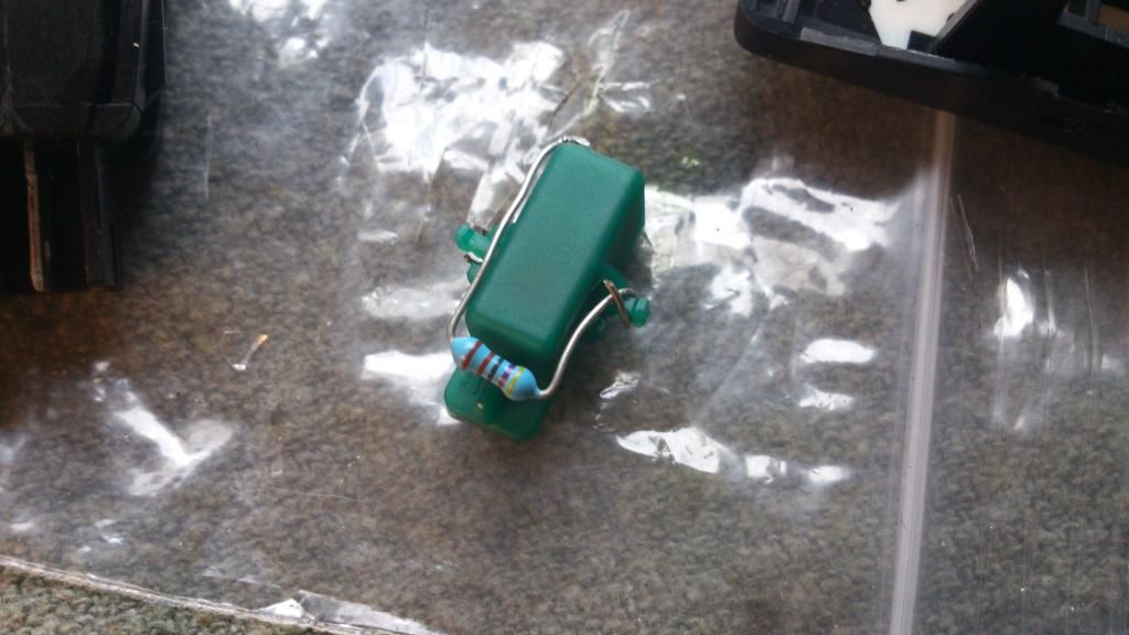

Tinkering today - I have been inspired by Russ and his great ideas for LED lights in the switches so I set about fitting some of them to the door switch and seat switches that had blown bulbs.
I had a pack of 50 super bright white LEDs from an ebay supplier who promised he'd chuck in 10 resisters if I asked but he never did send them! So I had three resisters I procured from work to experiment with.
First up I removed the blown bulb then fitted the LED with the negative pin attached to the former contact peg of the blown bulb, the resistor fitted to the positive peg (peg either side of the green diffuser that carries the bulb) then router the resister to meet the other pin (+ve) of the LED. Solder together. I found you have to ensure everything is very close to the sides or it interferes with the switch.

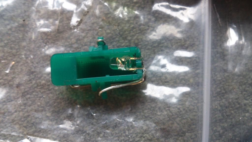

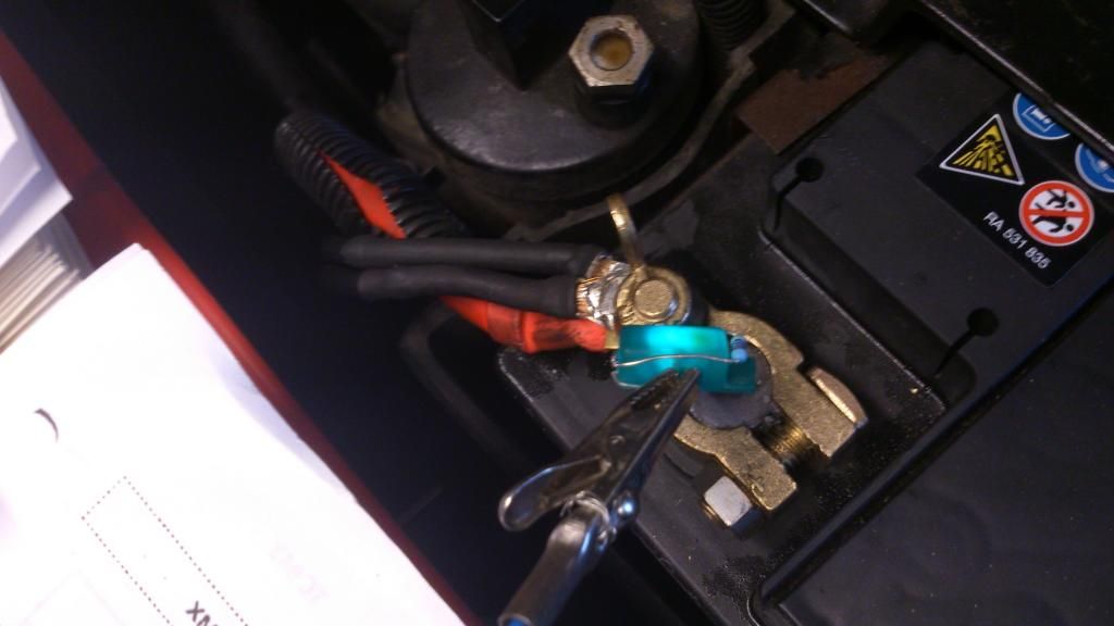

Quick pre fit test
You have to get the orientation of the LED inside the green diffuser right as the LED has a direction. A quick PM or two to Russ highlighted this and on the one in the photo I got it a bit wrong.
I also managed to blow a few LEDs as the pins of the LED were too close to the positive feed inside the switch that it shorts out. Took a bit of time to realise that's what happened. I installed the forst one to the passenger door and found that it didn't cast much light through the switch so I had made a doubled LED one with two LEDs in the diffuser both pointing upwards but this was the other one that blew so I only put one in each of the other two I made.

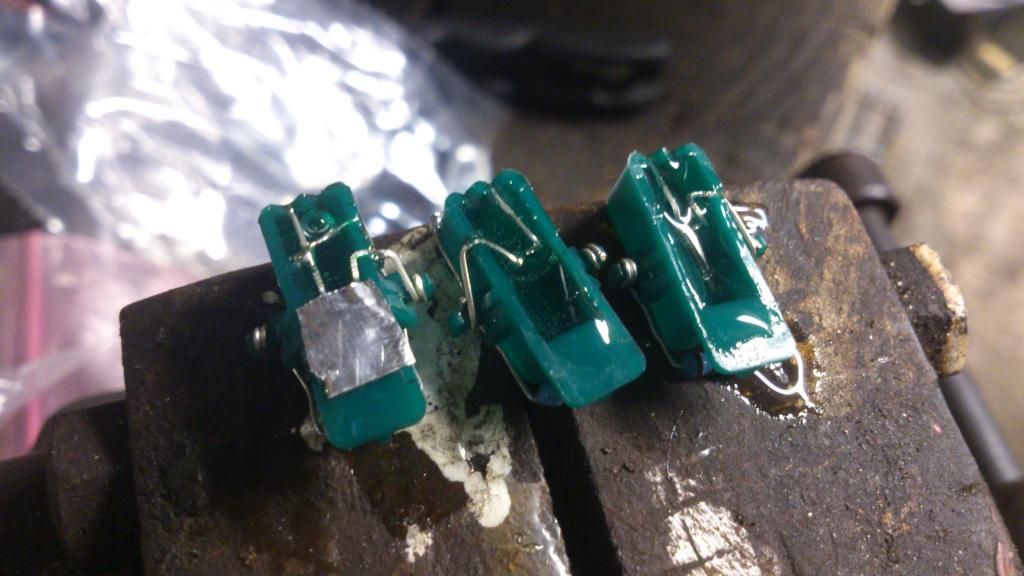

Once all three were tested I set about insulating them from the positive feed of the switch by filling each with clear resin and adding a little square of aluminium tape underneath to reflect the light up a bit more. With the aid of a heater the resin set solid in an hour and a half
So I now have a well-lit pair of driver seat switches and a semi- lit passenger door switch (I'll be redoing this one). For a first attempt it's working ok. think the other 7 I need to do will be a bit modified again with 2 LEDs in each.
