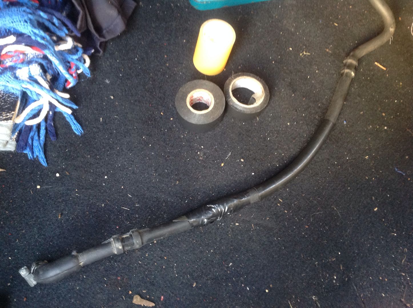

Post by russ92xmsed » Mon Nov 02, 2015 3:46 pm
Pipe has been replaced. An easy job. The one next to the brown plug, with the 90 degree elbow.
My rubbish temporary emergency fix.

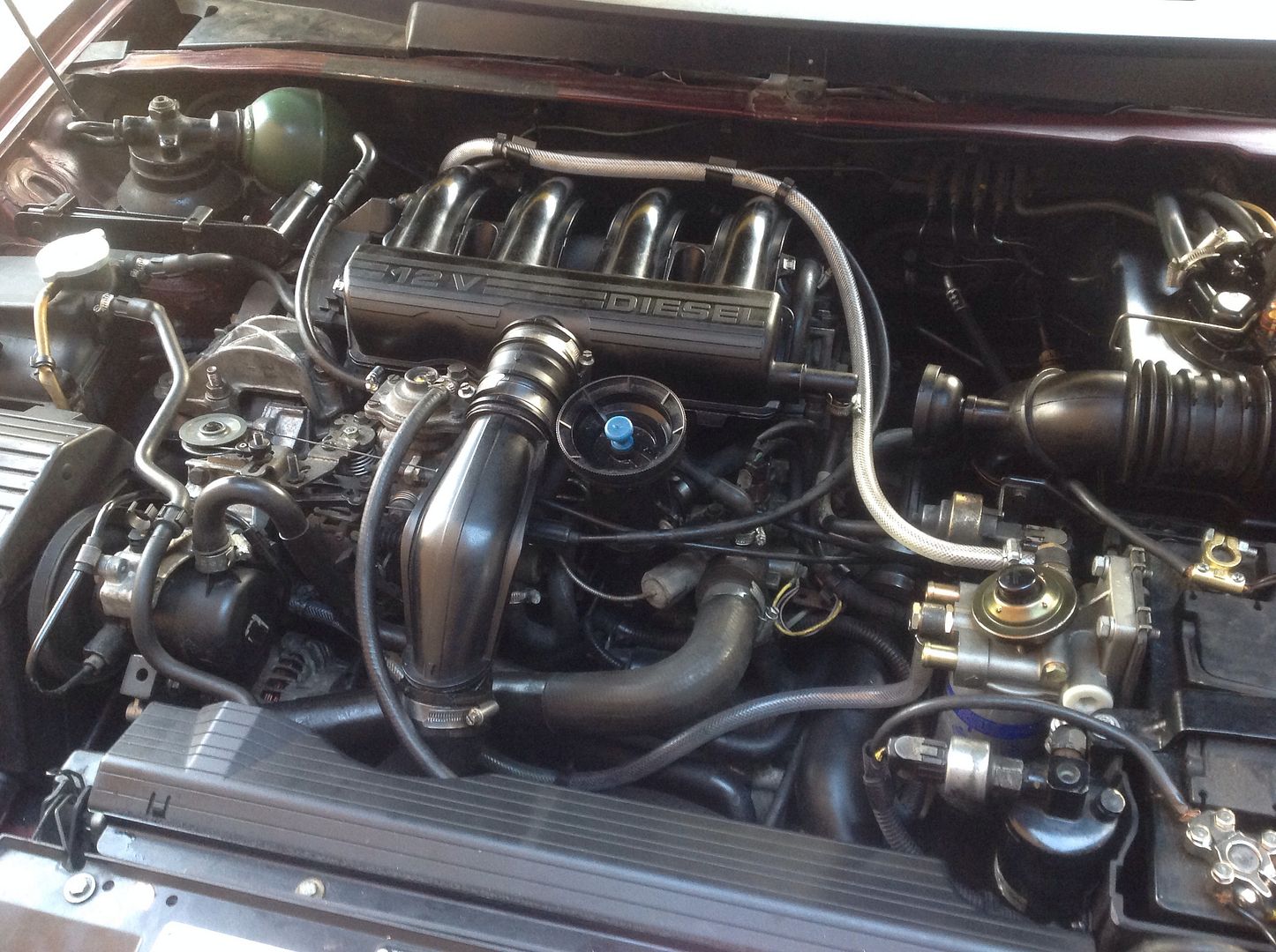

And a long overdue pic of the engine in situ. Looks like any other 2.1!

Post by raynoon » Mon Nov 02, 2015 5:36 pm
Looks like any other 2.1 STRAIGHT OUT OF THE BROCHURE! I wish both of mine looked like that!!
1993 Citroen XM 2.1 turboSD auto
1995 Citroen XM 2.1TD Auto EXCLUSIVE
Post by russ92xmsed » Mon Nov 02, 2015 6:05 pm
:lol: Wet wipes Ray.... Amazing what they can do to an engine!!! :lol:
Seriously it's not that good! But thanks. :D
