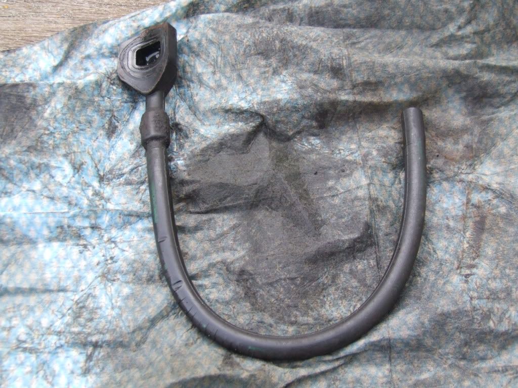

So I did me pipe. Quite straight forward to do. The clip was a bit of a mare. Clever design, just need the right tool really to unclip and refit. So unfortunately I had to resort to cable ties instead. But I still have the original clip to be refitted by someone who can!
I'm a little confused however. The strut end just presses agianst the strut and the clip helps seal it. Is this right as I found no sealing ring or anything else to suggest the pipe plugged into some sort of connector. :|
you'll have to bare with me on this...inexperience showing :lol:

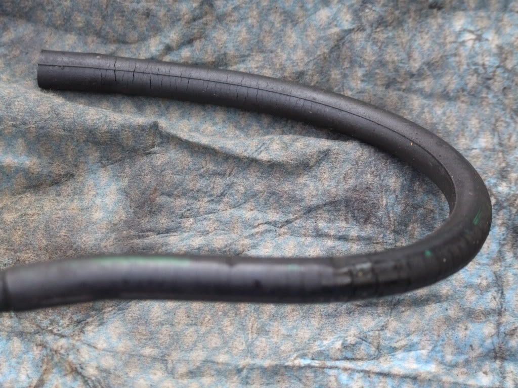

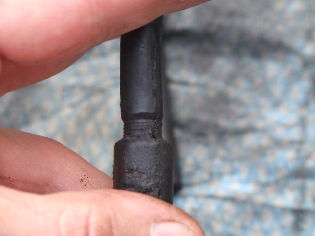

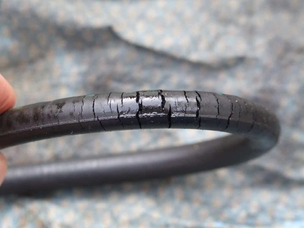

Some pics of the old pipe. It had really gone. It was hard and crispy up by the small black pipe and very split all the way down. I tooks some pics of the pipe, rather than the process of changing it as that, for you lot anyway, is rather small job!!! :lol:

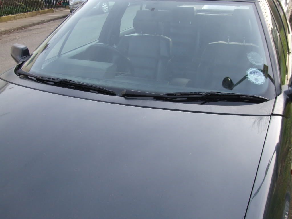

I put it all back together with no apparent issues, gave it a clean & topped up the LHM... and this afternoon I finally sorted out my windscreen wipers!!!! :o
So Will, if you read this, they are back to where they should be! :D
The drivers side took me ages to bend back into shape. Everytime a put it back on the spindle and tightended the nut up it would lift the wiper arm up...so I was left with a hovering wiper balde. Not good. Anyway all fixed now.

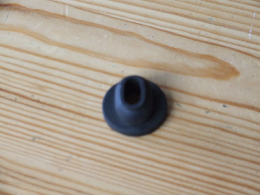

And then I found this under the car.
Please someone confirm to me it is a rubber gromet from one of the spindles of the scuttle panel and not a sealing washer on the pipe I have replaced?!! :? it is not greasy or oily.......

That grommet is one of the plastic scuttle retaining rings.
Good to see the wipers back where they belong, it make such a difference to the look of an XM.
Pincers are the tool for the pipe clip, but I have used pliers and a small screwdriver before now.

Thanks Will. It does look a lot better doesn't it! :D

It's hard to describe how to use the screwdriver, but basically use the shaft as a small fill piece to press the inner clip back to allow the outer to slide over it.
Pincers work best.

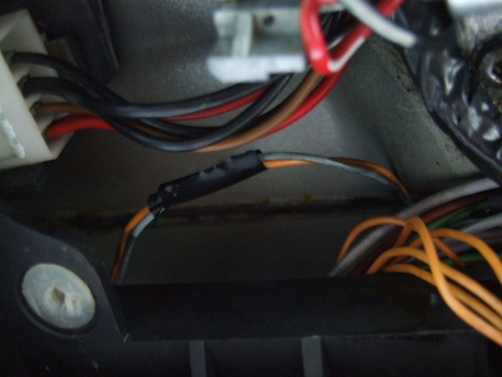

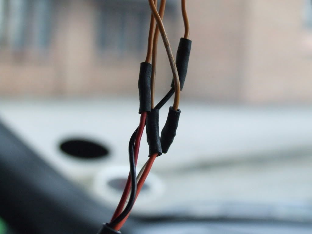

After John suggesting checking the wires going to my mystery circuit board...which we think is an old CX or BX receiver, and hence should be a hard code device which needs a specific coded key plipper for it to work...or so i understand ;) .....hopefully i can work out to see if I can fit a receiver that will work.
So this afternoon I did just that and there are 4 orange wires running to the circuit board. And a 5th that is in the same bunch of wires, but loops round and disappears again back into the roof with a pale blue wire.
You can see everything in some pics I took.
This mess of a board, still had power running to it. It must of touched one of the metal strips in the light panel, as it suddenly sparked. So I thought...NO, not having this potentially sitting up there sparking away. So I have cut it out and removed it. I made sure however the wires were colour coded and are now taped up sitting in the safety of the space where the receiver should be. Strangely the wires from the circuit board are White, Red, Black and orange, and they were soldered onto the original 4 orange wires that appear from the roof. So from this they must have been Live, Earth and two others.
Anyway pics below...
The connections
4 orange wires and the 5th which loops round....
...and disappears with this pale blue wire.
So I hope this is good news, meaning maybey I can fit a proper Citroen soft code reciver. but something tells me this might be too easy... 8-)
