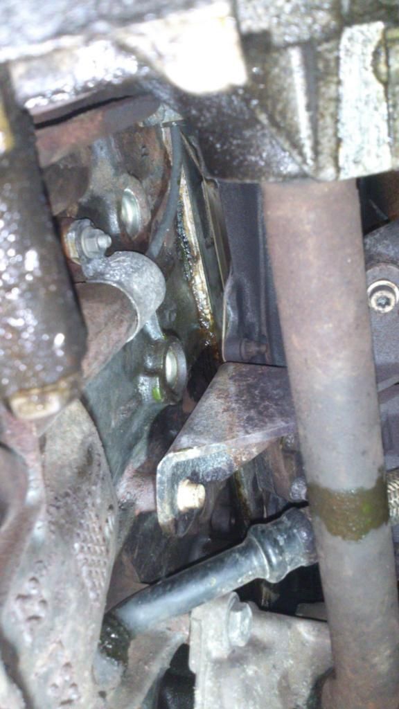

								by Aerodynamica » Sat Feb 14, 2015 6:06 pm
You can make out the coolant getting out at the gasket. It's not the core plugs of the block below though it is confusingly running down to them and dropping off.
Btw what kind of socket is needed for those exhaust bolt nuts? Is it just a normal socket?
						Post
								by Dean » Sat Feb 14, 2015 6:09 pm
			Yep that's he head, your not hanging around are you!
I'm sure despite how they look they are standard sockets but they could be torx the same as the head bolts
