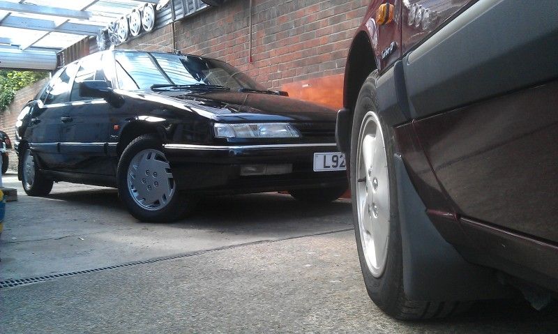

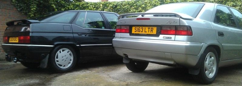

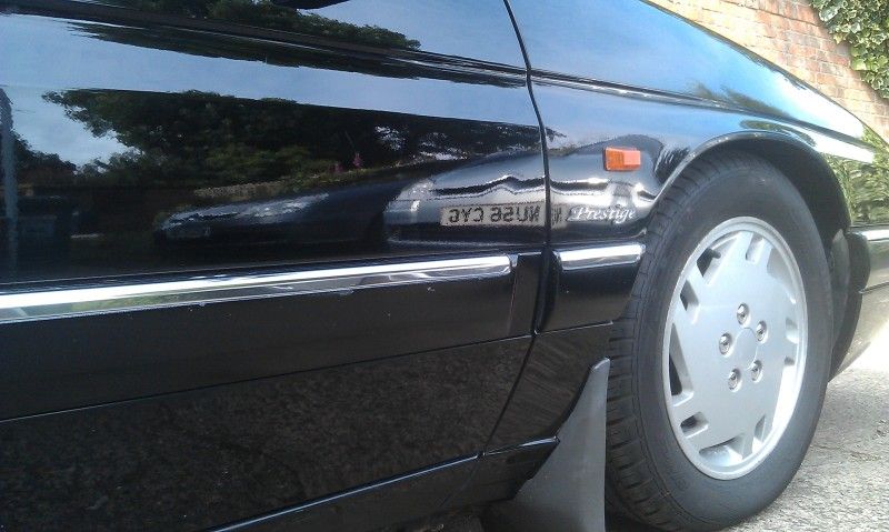

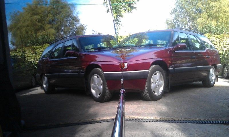

A few pictures of my XM after a bit of a go with a machine polisher:
Its improving, I doubt its previous owner would recognise the car now. Though its paintwork is a long way frm being close to perfect, it is looking much better and a much deeper black this a shine to it.

It is beginning to look quite tidy.

Looks stunning. How easy was it to replace the chrome trims. I've got some Brian Primmer ones waiting to go on.

They are a bit fiddly to do, but well worthwhile. Be very careful to apply enough mastic and not bend the trim at all, then tape down with masking tape until dry.
The idea is to fit one end then slide the trim to get the other end in, then centre it.

Ok thanks. Do the old ones just unclip? I'm not sure who, but someone did talk me through the process at the X rally, and they mentioned using "tiger sealant". M

The original ones do just unclip. Any sticky mastic will do, I think I used Sikaflex.
