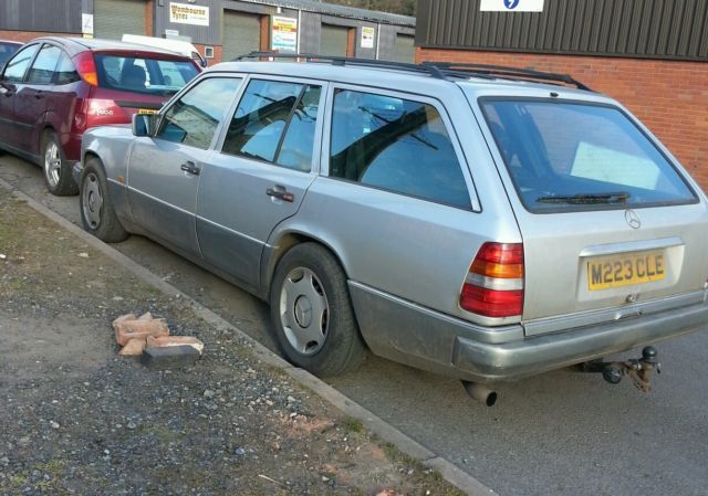

Looks like you're getting on well again Paul, and so pleased you got some glass! Sad to say I'm not going to be able to buy it in the end now; I needed a faster solution and ended up with a W124 diesel estate that was too good to pass on...

Jealous.. i soooooo love the w123 merc.. even more so in Traveller guise.. nice one!

I will but it's a W124!
