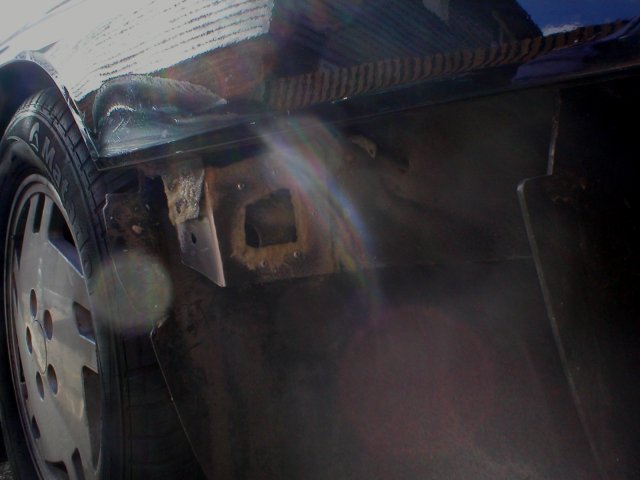

After a day of being absolutely unable to do anything at all on Friday I woke up feeling much perkier today and set-to on the XM with much assistance. I was keen to get the nose and bumper back on before the bad weather sets in...
The first task was to repair the bumper mount on the offside, the nearside being fine...
This was the extent of the damage:
We, as it's beyond me now to do, made a repair piece with some aluminium sheet and some pop rivets. That was used with a good coating of cavity wax to make a repair plate..
Not a good picture as it's been a lovely day and the sun got in the camera...
It's strong and does the job a treat...
After another small repair on one of the bumper lower mounts we reassembled and was delighted to see the new bracket is doing the job a treat...

Bumper mount brackets are a common disintigrater...
My Black M reg Onyx was in this state, however, after the thinkness of metal I used and welded it back in it would of out lasted the rest of the car had it of lived!
