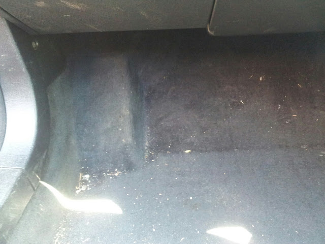

And I got the hoover out
And after
The carpets are lovely, come up so well with a good vac!
