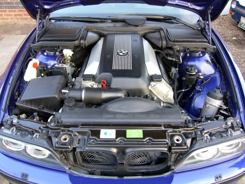

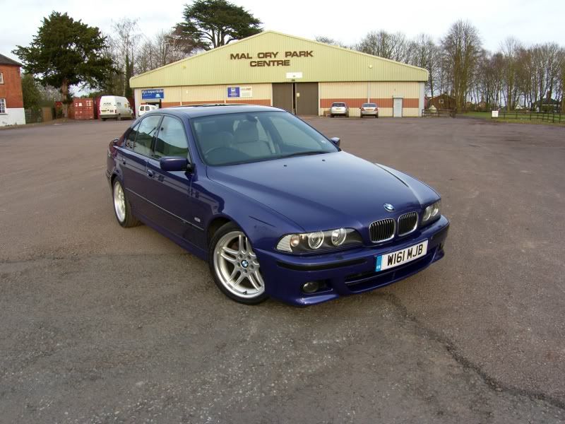

Not sure on a show winner, but it will be at a level where I am happy with it and secure in the knowledge that there will be no nasty suprises
This is how I like my cars (still miss this one, the pen*s that purchased it from me wrote it off two days later!)

I had a similar thing happen a good few years back when I sold my much loved 205GTi. Six weeks later it was dead after being squashed by an errant dustcart. Very upsettingturbo_imp wrote: the pen*s that purchased it from me wrote it off two days later!
