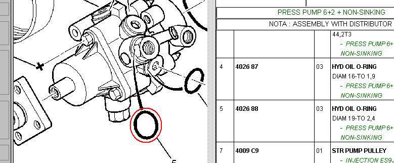

Post by CitroJim » Wed Sep 05, 2012 3:27 pm
That looks very nice Madis 8-)
What is the problem with the pump? They are not hard to repair if it is leaking. The common place is around the outlet union caused the the O ring circled in red in this picture..
The O ring is available from any Citroen dealer...
