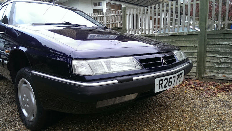

Re: R267PGF 2.0TCT - Winter Wash
Came over all car-cleany and gave my car a wash.
Cleaned the wheels with G101 and foamed her up
2bm wash with Farcela bodywork detox, then dried.
Then...
Was a bit too cold for hard wax, so laid some of this down
Went over the miles of trim with CG Trim Restorer, the miles of glass with isopropyl alcohol and again over the glass with RainX
Car up high for doing the bottom trim helps alot! Good for washing the arches too
Should do for another 6 months!
...wow! Nice job Sam. Looks great.
The pic of the car all sudded up looks like it has the worlds smallest and most pointless rear wiper!
I know it is a trick of the eye...
Looks incredibly simple. Is this miracle stuff that loosens up the dirt and leaves a wax layer, I have no knowlegde about any of this stuff. But the result looks great. Nice car!
Cor, that shines Sam
All mine need the same. I've not cleaned any of mine for months - certainly well before CXM. Just not had the time.
Even my dad noticed how mucky the XM was
Your winter wheels are here Sam. When you collect them you're more than welcome to wash and polish mine
Ditto here. Even liz who thinks washing cars is something very very strange, mentioned vaguely about her plans maybe maybe wash that XM somewhat Pointless exercise though, if you live in the country side of Western Ireland..
