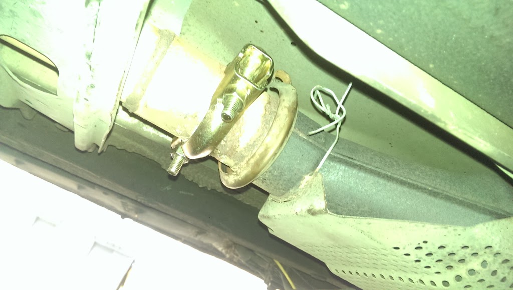

Fully sorted the exhaust! Took the time todrop the whole centre section, clean the mating faces up and smother it in exhaust fitting paste! With the whole exhaust rotated slightly which lined everything up bob on and I think something that wasnt done when last fitted it works perfectly! Silent on idle (can hear the engine more), slightly throaty on hard hoonage but I think its meant to be like that.
Cant really tell but the paste was oozing out of the clamp. Expands when hot and cured too, it took a day for it to fully stop the blow!
Re-used the back clamp as it was fine. Again, paste oozing out
