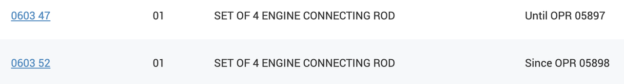

I see there were two different factory part numbers for the rod bearings, but I don't understand what this OPR number is.
Here's the data plate from our car:
I don't see any number sequence with enough digits to be that OPR number.

King Bearings list P/# MB5129AM KING but for the RFZ engine and it shows the width to be 20mm. You could contact them, however on their online shopping site they don't show the 2 litre engines at all.
Work your way through this list and either make contact with the supplier, or directly to the manufacturers, such as Kolbensmidt. See https://www.kmotorshop.com/en/article-l ... 0?filter=0
The part numbers you require are for the R6a engine, 95650951, or 0606 J5.
