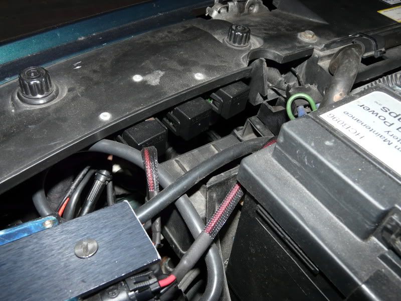

Should be on nearside (uk, battery side) behind headlamp, should be 1,2 or 3 relays in a row, depending on model and trim. Usually black and not green, second thoughts heres a picture-
Just a removal and clean up of the contacts may be all it needs as they are susceptable to corrosion in the daft place they are situated, I had all mine out and gave them a good coat of copperslip before reinstalling.

Must be a s2 thing as I've just gone outside and wobbled my relays (as you do!
) and on
the handy s1.5 K plater the x2 on the driver's side above the headlight are the lights - the outer
of the pair is the dip relay.
Do you know for certain the relay you're trying is a good one - try swapping it with the inner
main beam one?
If that fails, I'll have a looksee at a nearby s2 - it's just a longer walk in the dark!!
Andrew
main beam one?
Andrew

MY MISTAKE it is single one on drivers side, just been and pulled it out and no dipped lights!

My 1999 V6 definitely has the relay on the drivers side (RH side). I gave up cleaning the contacts in the connector and ripped them out. I intend to solder on a wiring extension and re-site the relay away from the moisture that gets to it at this location. I only went for HID's on dipped as they seemingly don't like being flashed on the main beam. So much better at night now.

Turned out to be dirty connectors on the relay socket (black relay behind driver's headlamp)
Used a bit of WD40 & wiggled it & they came on. They are tempremental though, another wiggle & they come back, when I've a bit more time will give the contacts a proper clean.
