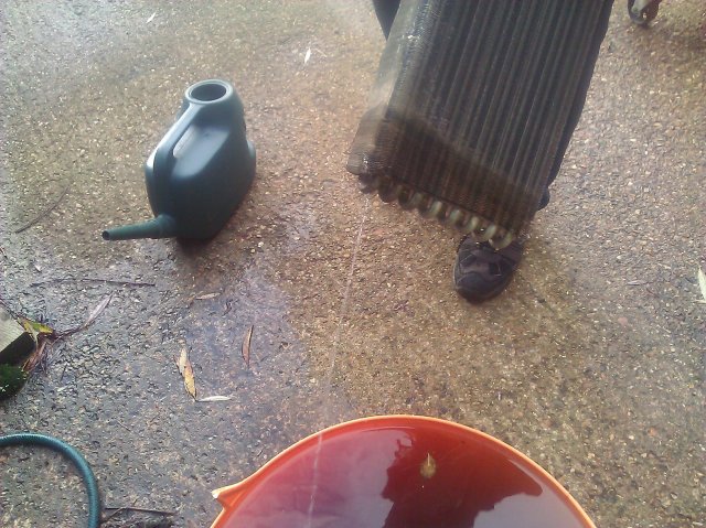

Thought you might like to see a couple of pictures of a Xantia heater matrix replacement I assisted with today.
It was a big job made bigger as the carpets had to come up as the failing matrix had made a bit of a mess of the front passenger footwell...
The extent of the leak being tested by filling the matrix with a watering can...

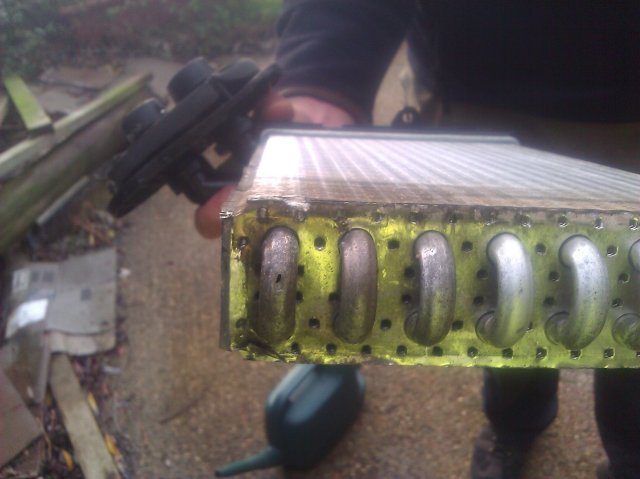

The responsible hole in one of the U tubes...
It was big and comparison with the new one suggests the old one was a tad longer in the U tubes than the new one. We believe the U tube may have fretted against the bottom of the heater box and holed itself...
This was an el-cheapo matrix fitted less then 12 months ago. Going cheap does not pay...

It does seem like an unusual place to go, whats the reason for the hole there? Thats not the common failing place, is it?

I saw one once jim ha had punctured ALL of its U Tubes...
All of them Paul :o Did you work out why?
Jaap, it's not such a bad job really - just long and tedious...
Speaking of tap water, I had a 205GTi a while back and that got through three matrixes in my ownership. All went on the U tubes and the cause I eventually discovered was a lot of scale in the cooling system; it had been run without anti-freeze for years which eventually killed the engine. The scale was circulating the cooling system and it acted as a fine abrasive and literally ground the U tubes away... The scale originated from the header tank...

Post by xmexclusive » Mon Nov 26, 2012 9:02 am
External abrasion damage is often due to a failure to fit the foam vibration strip correctly or keep it in place while fitting the heater.
Not easy to check on movement while fitting.
External abrasion is likely to be a single point major failure as demonstrated by Jim.
Pauls "all fail at once" is most likely due to crap materials/manufacturing.
There has been quite a bit written about those bends wearing through from the inside due to flow cavitation and fine debris abrasion.
I seem to recall that Valeo researched this rapid failure problem quite a few years ago.
Poor quality metal material used for manufacture appeared to be as much a factor as using non spec coolant top ups.
My conclusion at the time was that Nissen item did better than the standard items sourced from Spain.
