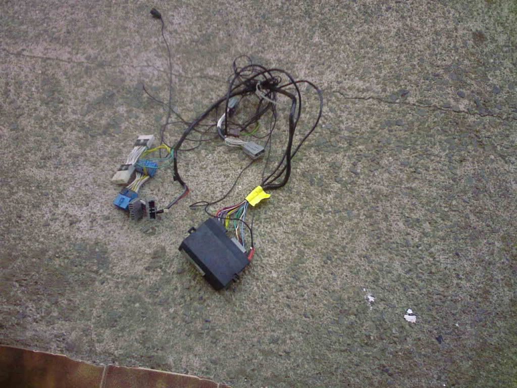

You don't need to remove the centre console, just the carpet side panelling. I have removed a couple of these now, both alarm control boxes have been pushed under the heater box. All the plugs where it joins into the harness are in the passengers side footwell, you'd be best removing the cover with the acess to the fuse panel and the plastic panel on the door shut at the front corner.
This is what you should end up with.

Chris, you will ALSO find the Keypad immobiliser above the passenger dash covering, above passenger feet. Its not needed as the ECU is de coded... just so you dont get alarmed (LOL, no pun intended) if you went looking.. ;)

well remember its there then because if the plipper packs up to disarm the alarm that would have been set off by opening the door you will have to turn on the ignition and press the little black button straight away to silence it.

The whole alarm unit as robert shows above comes out as a seperate complete addition.
