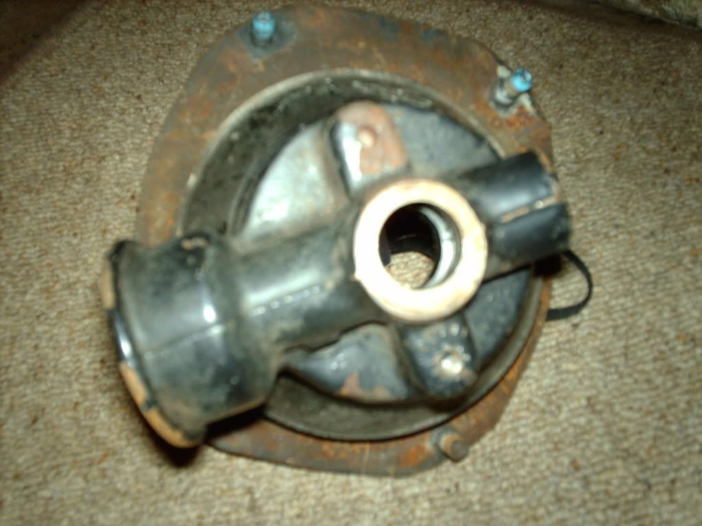

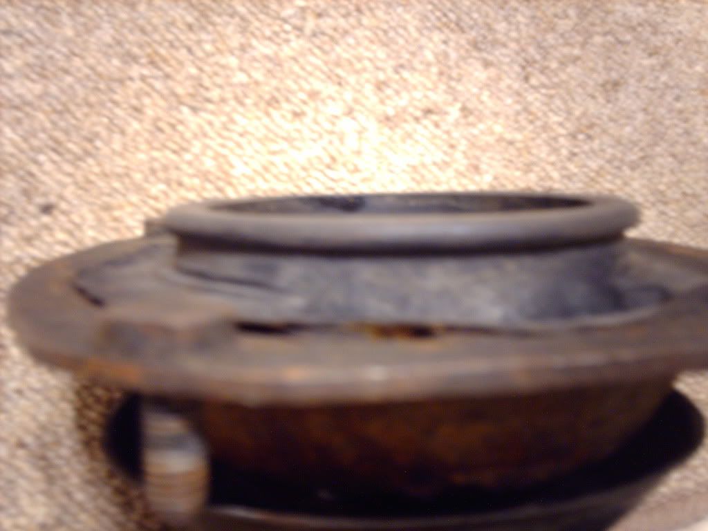

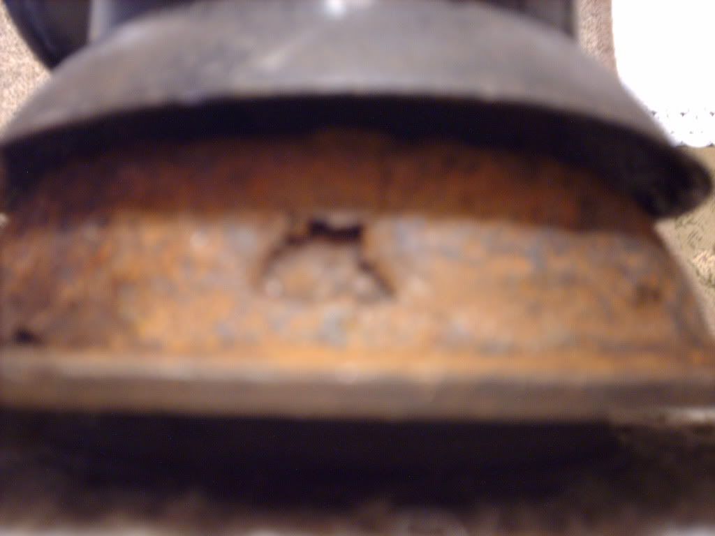

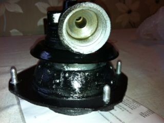

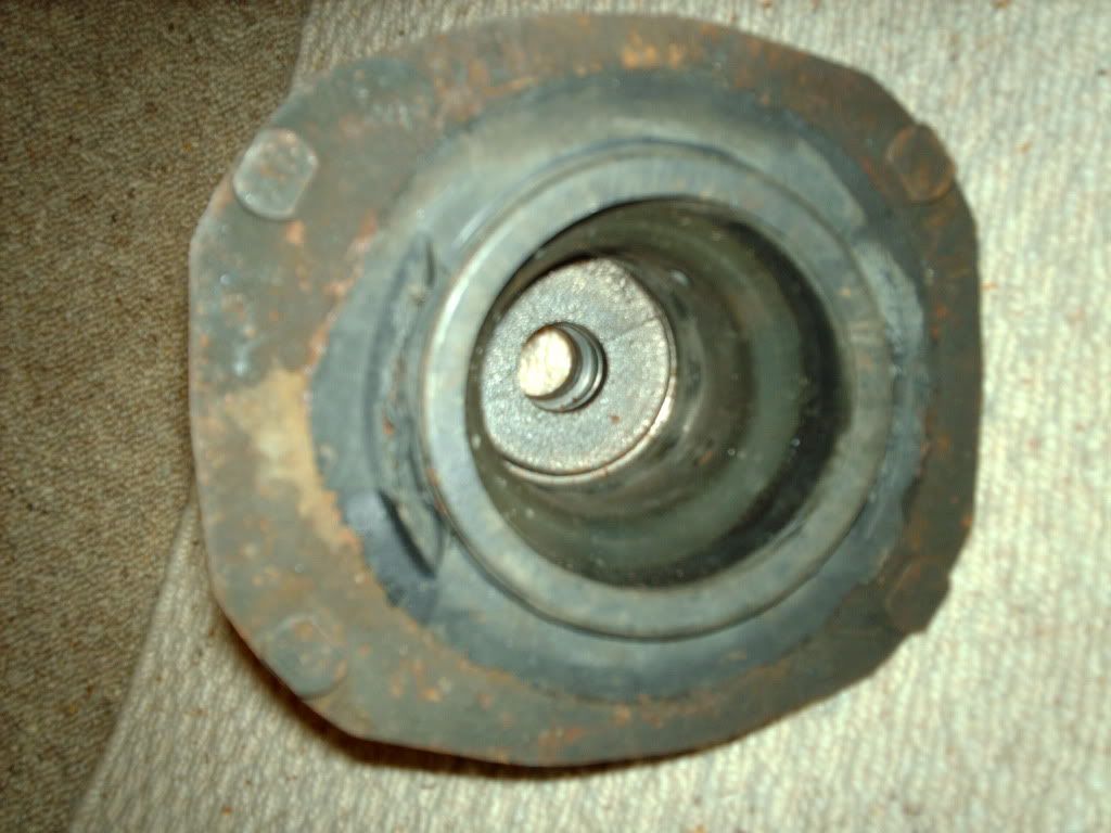

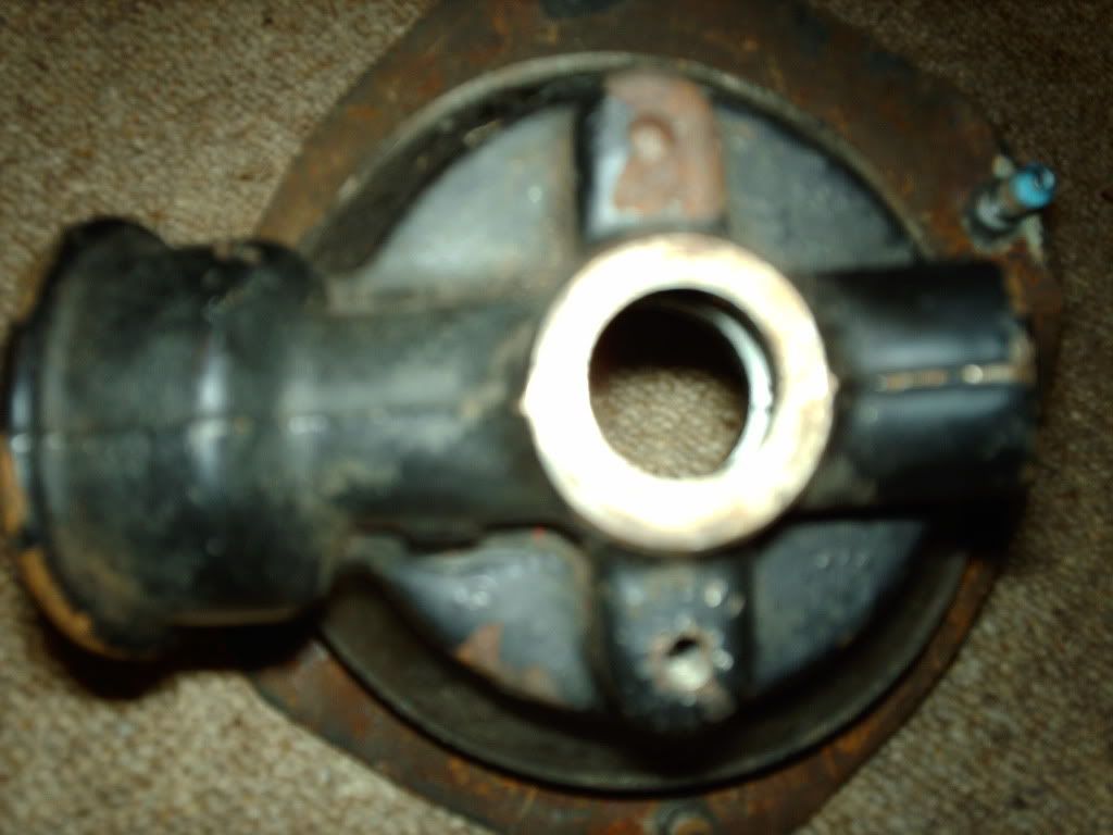

Heres the failing strut-top which was sent off to KINGas for refurbishment :-

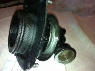

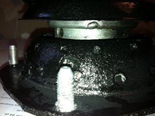

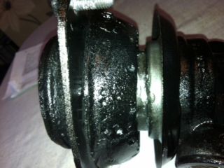

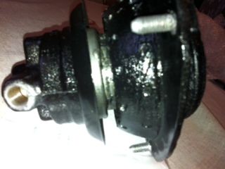

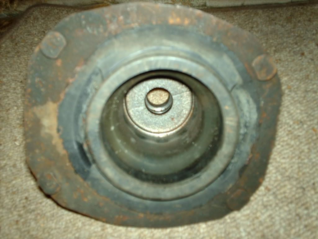

The returned (Supposedly same/unit) refurbished strut-top :-
I'm not sure what's happened to the profile/length of the 'Upper Dust Canopy' which is attached to the upper strut-top casting and the configuration/position of the lower flange plate which bolts to the under side of the vehicle ?
It maybe however that KINGAs have to machine the length the 'Upper Dust Canopy' lip down to enable to fit the components into the tooling jig/fixtures prior to the injection moulding of the 'Polyurethane' as I can remember that the initial prototype ones had them completely missing

It also looks like the protrusion of the neck (Which the strut leg/gaiter fits to), on the under side of the lower mounting plate is greater on Mark's unit now than previously and also than the ones shown in the initial/original KINGas posting too
If possible, (John or Paul) could you post up photo's of your strut-tops which you've had refurbished @ KINGas as a comparison ?

From the photographs I think the returned strut head is possibly not the one sent.
The original repaired strut head photos and the strut head sent are all of the earlier Citroen design with the short under ring.
The returned one seems to have the later deep under ring that Citroen changed to in late 1996.
Provided the strut hole size is correct old and new types are interchangable but need to be fitted with the correct matching gaiter.

John, IIRC the donor strut top assy. was from a M or N reg. vehicle so that tallies !xmexclusive wrote:From the photographs I think the returned strut head is possibly not the one sent.
Provided the strut hole size is correct old and new types are interchangeable but need to be fitted with the correct matching gaiter.
Therefore as Marks XM is a 2000 model, the gaiters fitted to his XM should fit correctly onto the 'Neck' on the under side of the flange mounting plate with the unit which 'KINGas' has return refurbished to him !
