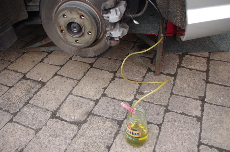

I'd rather change brake fluid than a master cyclinder or seized caliper.
I've got all the High-tech kit to do it, so why not...
